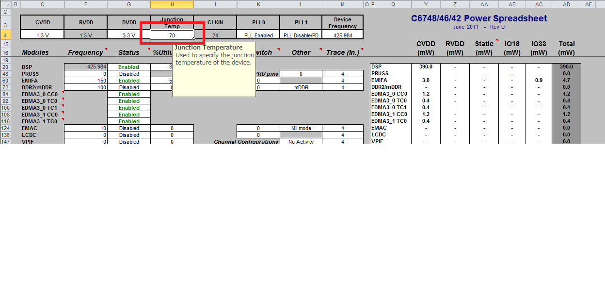

    Please take a look at the following snippet:
    As you see, there is a parameter for junction temp.
    Question1:
    What value should we use for this parameter ? Can we use a value including some assumptions ? For example, like this case : The case temp is validated on their system so putting a little bigger value than validated case temp for this parameter.... Correct ? Please note the preset for Typical 300/456Mhz is using 25*C for this value.

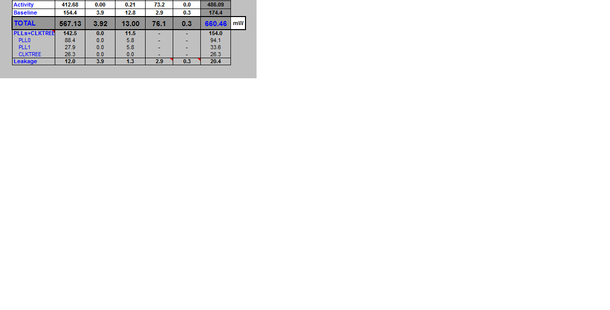

    I'm not sure the above assumption is correct or not, but anyway, something value will be set to junction temp parameter. And after some other parameters are correctly filled (for example, module usage, CPU/module utilization etc..), the spread sheet calculates the active/static/total power consumption. The following the result from Typical 456Mhz.
     From my understanding, these values can be referred as inputs to "Case Temp Measurement" tab in the spread sheet.

    At this point, which value should be go to #3 & #4 on "Measurements from Actual Application" ?
    [MB] Ideally you would have power measurements from a real system/PCB and along with which you will have ambient and case temperature. The case temperature tab allows you to calculate Tjunction, assuming worst case leakage/static power - as #4 maybe the static power measured on a typical/nominal unit in customer system, and #7  gives the worst case leakage possible - since customer will not always get units that are representative of worst case leakage, this spreadsheet tab allows you to comprehend this by replacing "measured" static power with worst case static power. Since the customer does not have the ability to isolate the device power , they will need to (as you said) use the power estimation spreadsheet and roughly estimate their junction temperature in the main tab to slightly higher than what they see their case temp to be.
    You can refer to section 4 and 5 of the thermal application note.
    This is mentioned in the power consumption summary wiki
    processors.wiki.ti.com/.../OMAP-L138_Power_Consumption_Summary
