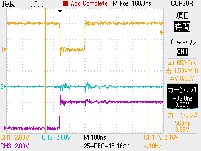

BE0n,BE1n(Byte enable) signals specification of AM335x ?
I confirm it in AD multiplex of 16bit of GPMC in AM335x.
The BE0n/BE1n(byte enable) terminal is the following output.
①Lower byte access
BE0 low:BE1 high
②Higher byte access
BE0 high:BE1 low
③In the case of word access
BE0 low:BE1 low
It does not have any problem that BE0,BE1 signal becomes low active.
BE0 becomes low at the same time as CS becomes high.
However, BE1 does not change at the same time as CS becomes high and seems to maintain the value.
The above according to specifications of AM335x will work?
Because the timing of the details does not write it to see TRM and a data sheet of AM335x either, I ask you a question.
The following wave pattern becomes CS,BE0,BE1 from the top.
case ②Higher byte access
case  ①Lower byte access

    I see nothing wrong with these waveforms. The BE signals should be at valid state when CS is active.

  • Hi Biser,
    I understand that the BE signals should be at valid state when CS is active.
    I think that BE1 is as follows for a wave pattern in case ② Higher byte access.
    CS:high->low->high
    BE1:high->low->high
    However, actually, it is as follows.
    CS:high->low->high
    BE1:high->low->low
    Is a way of thinking a mistake?

    Section 7.1.3.3.9.1  of the AM335X TRM Rev. L, comments on BE behavior:
    "When either RDCYCLETIME or WRCYCLETIME completes, if they are not already deasserted, all control signals (CSn, ADV_ALEn, OE_REn, WEn, and BE0_CLEn) are deasserted to their reset values, regardless of their deassertion time parameters.
    An exception to this forced deassertion occurs when a pipelined request to the same chip-select or to a different chip-select is pending. In such a case, it is not necessary to deassert a control signal with deassertion time parameters equal to the cycle-time parameter. This exception to forced deassertion prevents any unnecessary glitches. This requirement also applies to BE signals, thus avoiding an unnecessary BE glitch transition when pipelining requests.
    If no inactive cycles are required between successive accesses to the same or to a different chip-select (GPMC_CONFIG6_i[7] CYCLE2CYCLESAMECSEN = 0 or GPMC_CONFIG6_i[6] CYCLE2CYCLEDIFFCSEN = 0, where i = 0 to 3), and if assertion-time parameters associated with the pipelined access are equal to 0, asserted control signals (CSn, ADV_ALEn, BE0_CLEn, WEn, and OE_REn) are kept asserted. This applies to any read/write to read/write access combination.
    If inactive cycles are inserted between successive accesses, that is, CYCLE2CYCLESAMECSEN = 1 or CYCLE2CYCLEDIFFCSEN = 1, the control signals are forced to their respective default reset values for the number of GPMC_FCLK cycles defined in CYCLE2CYCLEDELAY."

  • If you don't insert CYCLE2CYCLEDELAY the BE0/1 signals will not be deasserted between successive accesses.

  • If you don't enable the delay there will be no change of the BE0/1 value.

  • What is the type of access when BE1 doesn't change? 8-bit or 16-bit? Even address or odd address? Read or write?
  • Hi Biser,
    Thank you for your reply.
    I reply your question.
    device type:16bit
    access : 8bit
    write access
    odd address:
    waveform of "case ②Higher byte access"
    even address:
    waveform of "case  ①Lower byte access"
    In the case of read access,BE1 does not have the change and  BE1 holds low.

  • Shigehiro, i think in general the control signals will act differently during non-active cycles (when CS is high) depending on pending transactions.  This is outlined in the TRM excerpt that Biser gave earlier.

  • Shigehiro,
    The controller may pipeline certain transactions to gain greater efficiency on the interface.  So depending on the sequence of accesses that is necessary on the interface, there may be, for example, back to back reads in which you won't see the control signals deassert in between cycles.  In other occasions, the you may see the control signals deassert.  It just depends on what transactions preceded it and succeed it.
