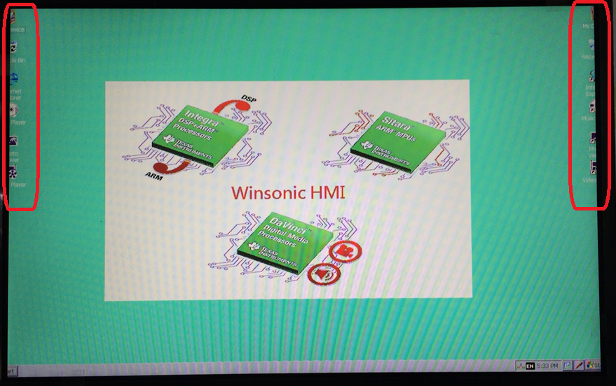

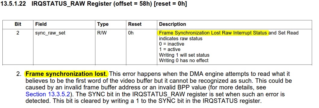

Hi All,
We encountered a problem of the 'Frame Synchronization Lost' issue, it will display the image with a horizontal shift(the leftest image shift to the rightest). Please see the pictures.
It does not always happen, but frequently. We try to reduce the TFT-LCD pixel clock frequency, it seems workable, not find this kind of shift anymore.
We are curious to know what's the root cause. Do you have ever met this problem? Any suggestion will be welcome. Thanks.
Jeff
the TFT is 1280_800@60, pixel clock 69Mhz (reduce to 65Mhz)
