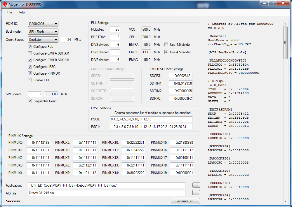

                  Am using OMAPL-137 on my custom board and able to get the BOOTME string on the hyperterminal when i boot it through UART1. So, now am trying the flash the .bin file to External flash memory(SPI1) and through uarthost.exe. But, am gettin the below messages when i try to flash!!..
Steps Performed:
                           1. I have build the project on ccsv6 and i have got the DSP.out file.
                           2. DSP.out file is converted to test281215.bin file using the AISgen.exe
                           3. Am trying to flash test281215.bin file through uarthost.exe . but, am getting the below errors.
                           4. Baud Rate set is 115200.

So, can you please let me know how do i solve this problem??
