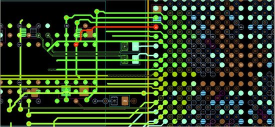

    Have you seen a board with short traces twice as long as they need to be?  I want to make sure I'm not doing something foolish.
    Look how nice that red trace looks.  I'm going to have to double its length at least.
    Also, are there any guidelines about how tight the switchbacks can be?  That is most likely up to the engineer.  It means I have to worry about inductive coupling reducing the amt of delay and capacitive coupling fouling up the eye diagram.
  • While I agree that the highlighted trace is ascetically pleasing that is not what matters most here.  Folded back serpentine routes are par for the course for DDR routing.  DDR uses a source synchronous bus thus what really controls input setup and hold is the skew between the clock at the information being sent.  The only way to equalize the length of traces in a bus is to extend them all out the the longest one of the net class and clock.
    The way to optimize the route is to ensure the longest route of the address/control bus is a short as possible.  This will minimize the added length needed to length match the bus.  One advantage you have with the tight placement shown above is you can likely get away with minimum spacing for almost all of it.  You are allowed to route the nets at minimum spacing for up to 500 mils of routed length.  This is intended for BGA escapes and routing congestion.  This applies to the serpintined traces as well.
    With respect to the length added traces, I would maintain a 4w spacing in between the cycles to minimize self cross talk.  If the entire length of the net is near 500 mils, you will likely be able to route the whole thing at minimums, including the serpentine cycles.   You do not need to worry about inductive or capacitive coupling provided you are following the layout spec.
    Also, do not attempt to length match the entire bus.  You only need to length match CK to ADDR/CTRL, DQS0 to byte 0, and DQS1 to byte 1.  Do not match across the clock domains.
    -Mike
