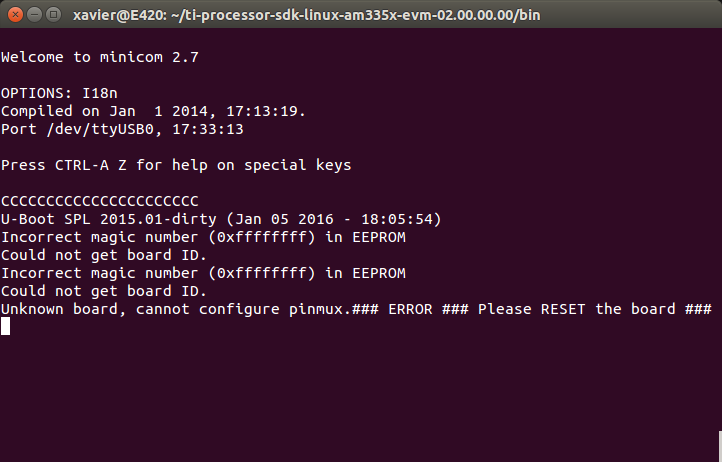

  • Hi Yordan,
    Thank you very much for your help!
    I followed your steps with some twisting, eventually I got the uboot loaded with error message:
    If I am not mistaken, this is due to the fact that I have an empty rootfs.
    Can you advise me how can I proceed to integrate the newly generated uboot with my exiting development Debian image?
    Thank you!
    Xavier
  • This is because, your board does not have the ID written in EEPROM.
    You should remove the magic number checks from u-boot source code & rbuild it OR program your EEPROM. Refer to the following post:
    e2e.ti.com/.../308033
    Yordan
  • Hi Yordan,
    After few days of trying, I finally managed to get the cloned board working.
    As you pointed out, the primary issue is the EEPROM. I was using the mainline u-boot and applied two patches, which one of them bypasses checking the magic number. In the end, I managed to program the EEPROM in u-boot and now also my exiting os can run on the board without issue.
    Thank you.
