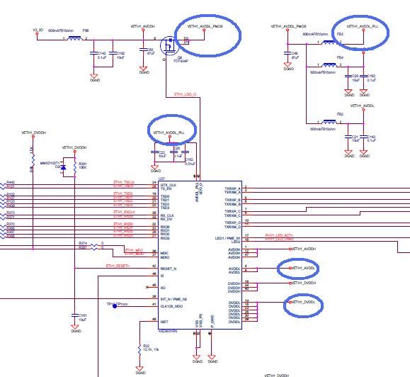

I have one doubt in am437x design that is in giabit ethernet phy chip design.
As per datasheet of KSZ9031RNXCA (phy chip) AVDDl,DVDDL and AVDDL_PLL maximum voltage is 1.8V.
But in the design applied 3.3V through P channel mosfet.
I know it is working fine in EVM .
Is there any reason to give 3.3V. Below is the design
