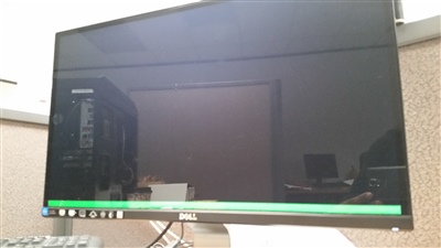

  • I didnot create a new thread. I was able to get the code working when I change the resolutions to the following:
    Capture Height : 525
    Capture Width: 720
    Display Height: 480
    Display width: 640
    For the above values I got the video on the the VGA, but there was 2 issues I noted:
    First of all,
    1. There was a green bar about 20 lines high near the bottom of the screen.
    In the above picture, I've disconnected the Camera. Even then the green bar was still there. Why is this green bar there and how can it be removed?

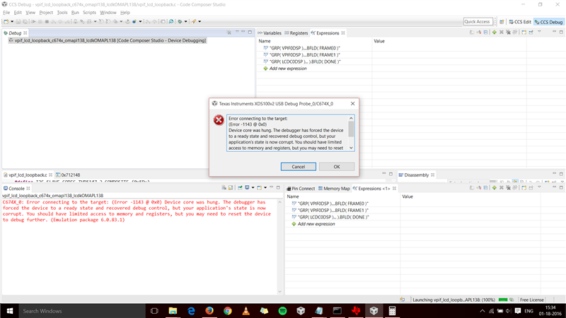

    It was then that I tried changing the resolution. Thats when the next issue came up.
    2. When i tried to change the resolution and debug the code, it would give a black screen on output. However, the next time I debugged, it showed an error as you can see in the below pic.
    If I press okay, it would go forward with the debugging, loading the program. But again black screen. Nothing not even the green bar shows up on the monitor. After this the board behaves the same way to any code change unless I reset the board and plug out and plug in the cables once. What could be the issue.

  • It was then that I tried changing the resolution. Thats when the next issue came up.
    For second time debugging (continuous debugging) , please POWER OFF and POWER ON or RESET the board to get the expected behavior.
