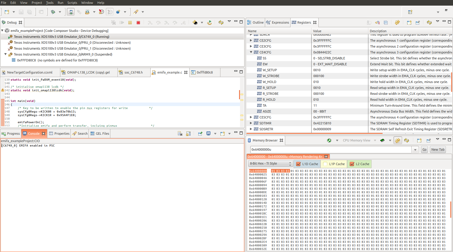

    Uint32 val_revid = emifaRegs->REVID;
    emifaRegs->CE4CFG =
    (CSL_EMIFA_CE4CFG_SS_SELSTRB_DISABLE << CSL_EMIFA_CE4CFG_SS_SHIFT)
    | (CSL_EMIFA_CE4CFG_EW_EXT_WAIT_DISABLE << CSL_EMIFA_CE4CFG_EW_SHIFT)
    | (CYCLE2 << CSL_EMIFA_CE4CFG_W_SETUP_SHIFT)
    | (CYCLE2+1 << CSL_EMIFA_CE4CFG_W_STROBE_SHIFT)
    | (CYCLE2 << CSL_EMIFA_CE4CFG_W_HOLD_SHIFT)
    | (CYCLE2 << CSL_EMIFA_CE4CFG_R_SETUP_SHIFT)
    | (CYCLE2+1 << CSL_EMIFA_CE4CFG_R_STROBE_SHIFT)
    | (CYCLE2 << CSL_EMIFA_CE4CFG_R_HOLD_SHIFT)
    | (CYCLE2 << CSL_EMIFA_CE4CFG_TA_SHIFT)
    | (CSL_EMIFA_CE4CFG_ASIZE_8BIT << CSL_EMIFA_CE4CFG_ASIZE_SHIFT);

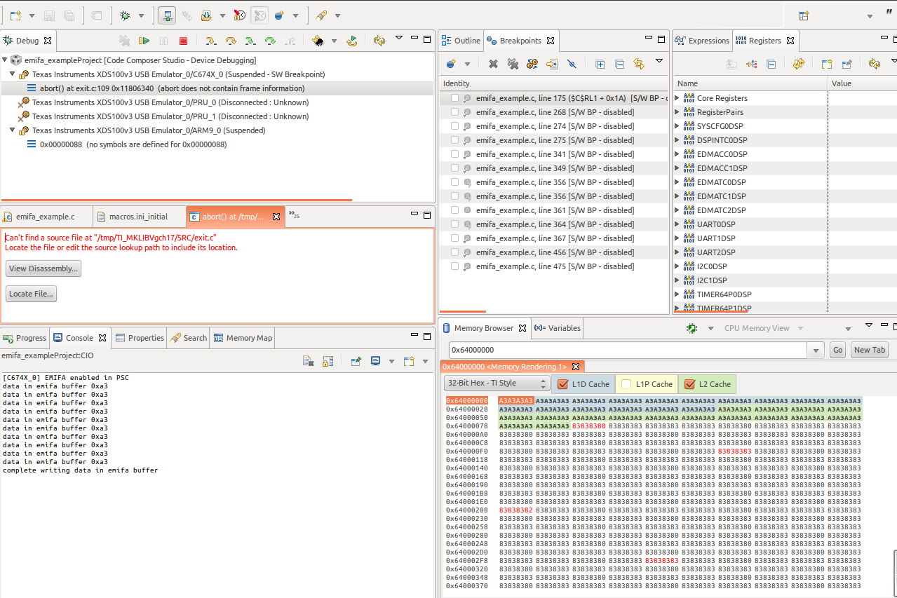

  • Dear Titus S,
    I ran my EMIFA test code in uart mode and started seeing emifa pins behave strangely. Without read/write to CS4 memory, it was seen that signals on WEn and OEn and CS4 were on and off continuously. please see attached screen shot below.
    Then checking CS4 memory in memory browser, it appeared that there were data there, which is a bit odd. I am just wondering if you have seen things like this before? BTW, I have attached my gel file when loading arm core.OMAP-L138_LCDK (copy).gel

  • Dear Titus S,
    It is very strange problem here. I enabled memory analysis. please see a screenshot below.
    I am new to CCS. Does it mean that L2/L1 cache have these strange value? where are these values from?
    (i am running it in uart mode)
    Cheers, Louie
  • Dear Louie,
    Don't put tick the L1/L2 cache option in CCS unless you enable and use the cache in code.
    What value you are getting when you haven't enable the cache in CCS ?
    If you want to test the EMIFA, then we have connected NAND flash on OMAPL138/C6748 LCDK boards which has 16bit NAND.
    You can run the examples.
    C:\ti\OMAPL138_StarterWare_1_10_04_01\examples\lcdkOMAPL138\nand
