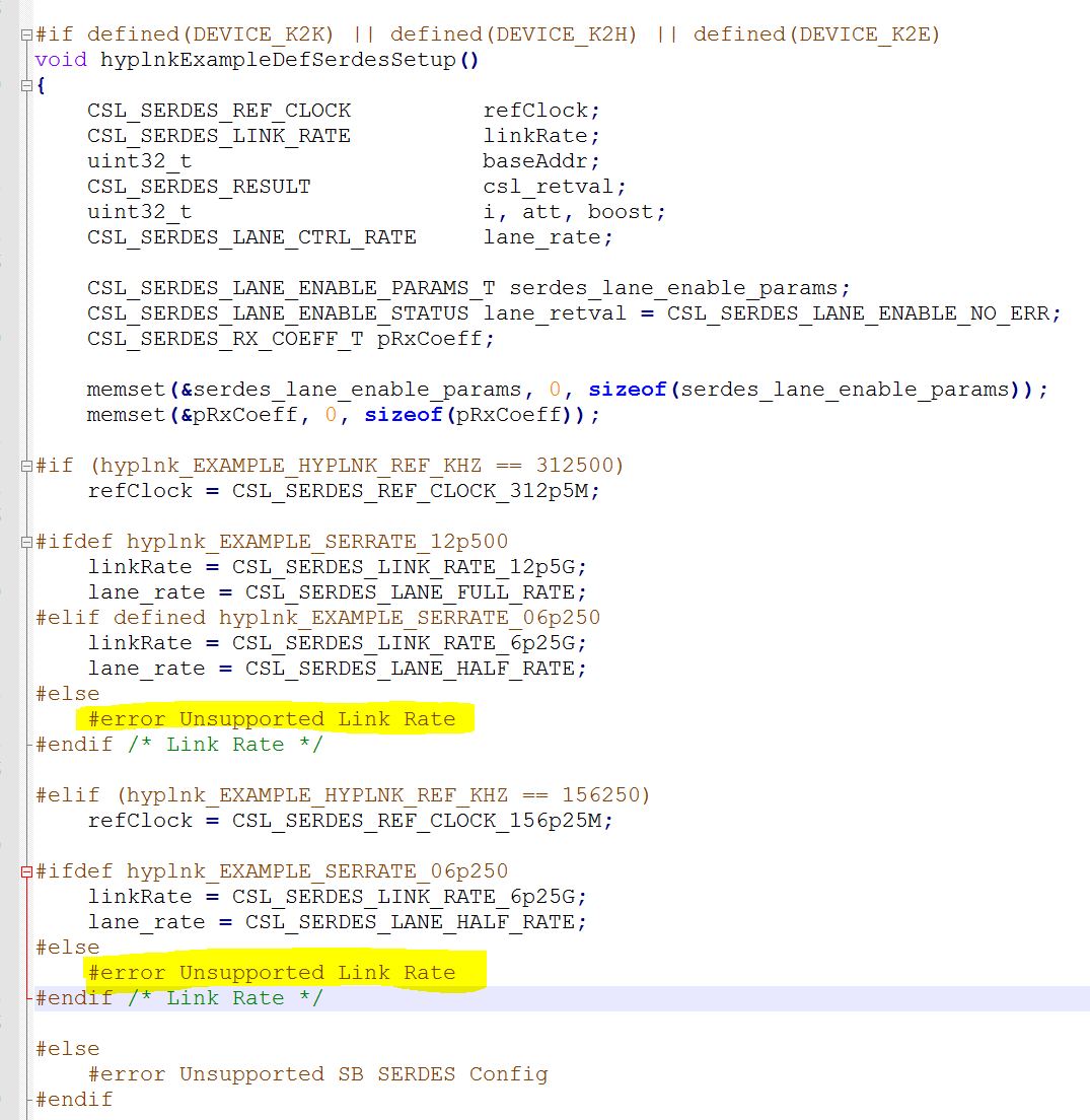

We are using hyperlink interface to 6.25g and would like to move to 10G however both pdk_keystone2_3_01_03_06 and pdk_keystone2_3_01_04_07 10G do not support this mode for 312.5MHz reference clock.
See attached screenshot taken from "C:\ti\pdk_keystone2_3_01_03_06\packages\ti\drv\hyplnk\example\common\hyplnkLLDIFace.c" for your reference.
Errata sheet for K2K/K2H does not reflect 10G issue.
Could you please confirm why this is unsupported?

    K2K/K2H device will support 10G Hyperlink link rate.
    MCSDK examples are based on TI EVM boards, two EVM boards are connected via Hyperlink cable for non-loopback mode testing. Due to the long cable(12 inches long), could only get a sustainable rate of 3.125Gbps. With another cable, managed to get a sustainable rate of 7.5Gbps.
    If you using your own custom board, then you can modify the hyperlink test code for 10G line rate. MCSDK hyperlink driver will support all line rates.

    Thank you for getting back to me. We did try this by modifying the code however we had a bring up reliability on the interface. Hence our team has decided to get support from TI. We can start investigating the problem but my guess would be drive strength between two devices could be a problem.
    Do you know how drive strength parameter values are derived in MCSDK. Are they tested in any way and if so, Are they setup for long cable or a very short track (<2 inches) which is there on our custom board?
    I have also looked at the user manual for serdes block here http://www.ti.com/lit/ug/spruho3b/spruho3b.pdf  but struggling to understand this as there is no description for bit fields.

  • Hi Ganapathi,
    I have tried playing with them in the past but they do not get used.
    Hyperlink example for K2H and K2K do not use those definitions at all such as TWPST1, TWPRE, SWING etc instead code path goes straight to serdes configuration in CSL and that contains just numbers and no description.
    See below where drive strength definitions are not used.
    This is what gets called on K2H/K2K processors.

  • Piyush,
    The KS II device supports Hyperlink up to 10.0Gb/s * 4 lanes. The swing, twpre, twpst1 are parameters for KS I device and don't apply to KS II.
    For KS II, the Tx parameters are C1, C2, CM, TX_ATT and VREG, Rx side parameters are RX_ATT and BOOST. For Rx side, those two parameters can be adapted from receiver or forced, if you run at a higher rate (e.g 10Gb/s), force with a fixed value is recommended. Those Tx/Rx parameters are described in http://www.ti.com/lit/ug/spruho3b/spruho3b.pdf.
    Need some info for your setup: is this KS II to KS II connection on your customized board? trace is ~ 2 inchs? Did you get any reliability issue when run 6.25 Gb/s? What is your reference clock (312.5MHz or 156.25MHz)? Did you do any BER sweep test to determine the best setting of Tx/Rx parameters? You running MCSDK example on DSP core? not ARM core, not running Linux Hyperlink driver, correct?
    Regards, Eric
