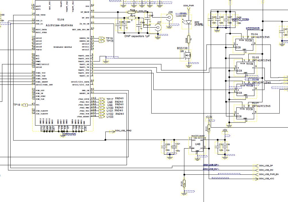

    No I only power the onboard USB 3G Modem with a GPIO, It requires 3.7V and we put a dedicated power supply for it.
    The VBUS is powered from the 5V of our board with a TPS2051. See a part of the schematic below :

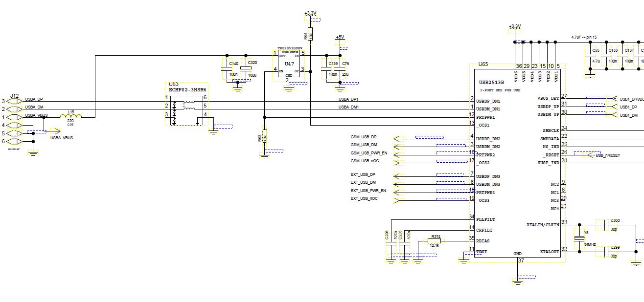

    You don't show the hub portion here, but I still think it's possible that you are confusing it. In this case, your USB modem is likely activating its USB DP pull-up immediately on power-up due to its VBUS being supplied from board power rather than a true 5V VBUS from the host (or the hub in your case). The hub would not expect to see the pull-up on DP until after it turns on VBUS as per the USB specification. If I understand your passing case correctly, you don't activate the modem until after the hub is up and running, which is what would be expected from a hub's perspective.
    The order of operations for a USB topology that implements a hub is:
    1) The host applies VBUS to the hub. The hub sees VBUS and activates its pull-up to signal the host that it is present.
    2) After the host configures the hub, the hub will apply VBUS to all downstream ports looking for attached devices.
    3) Any device attached downstream of the hub enables its pull-up to let the hub know it is present.
    4) The hub now reports attached devices to the host which then configures them.
    In your case, I believe you are skipping 1 and 2 by allowing the USB modem to enable its pull-up prior to the hub (or host for that matter) being ready for it.
    If I'm not wrong, the TPS2051 will be enabled only from the hub (GSM_USB_PWR_EN, connected to PRTPWR2). So in every case, the USB_VBUS of the U108 (3G Modem) will only be powered since the hub has been initialized.
    After that, I'll power up my modem and the hub will detect it ?
    Or I'm wrong ?
    I send you the hub part of the schematic. The port 1 is used externaly with a USB connector, the 2 is the 3G modem and the 3 is for futur usage on an extension board.
    Strange thing is that everythings works fine if I've a Memory Stick on the port 1... how can it change the behavior of the port 2 !!!
