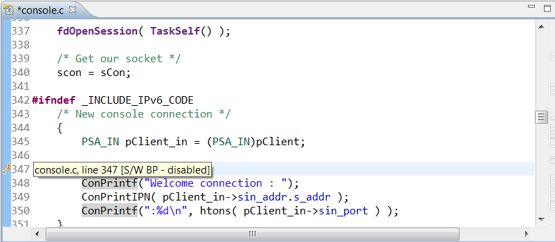

So I've tried to place a breakpoint at line 90 of file console.c (located inside \ti\tirtos_sitara_2_00_01_23\products\ndk_2_23_01_01\packages\ti\ndk\tools\console path), but CCS says software breakpoints are disabled (?):
Following the call stack during the exception, it sends me to line 90 of console.c:
Unfortunately, that line does not contains the call to NDK_vsprintf I'd expect: somewhere something got misaligned during crash report generation.
The problem should be sligthly above, at line 87, but still I can't place any breakpoint, and I don't know where and how NDK_vsprintf is implemented.
I've also tried to comment out all the ConPrintf() calls in console.c but, despice a clean/rebuild of the project, no change occurs at binary.
Hints?

    For setting the breakpoint... just before trying the telnet connect, can you set one on “xdc_runtime_System_doPrint__I” (in the disassembly view)?  And then step from there?
    And, you indicate “I've also tried to comment out all the ConPrintf() calls in console.c but, despice a clean/rebuild of the project, no change occurs at binary”.  That might be the most significant finding, if you aren’t able to fully build the project as expected.  Have you investigated this any further?

  • Scott, I've digged into deep and I discovered that I need to copy all the \ti\tirtos_sitara_2_00_01_23\products\ndk_2_23_01_01\packages\ti\ndk\inc\tools\console folder in my project (along with console.h) to edit/modify console.c. That's not an issue, and I prefer a local copy in my project folder, because I need to share the project with other colleagues.
    The exception problem is related to extern declaration of VerStr. Infact, in console.c I've found this:
    extern char *VerStr;
    But I've declared (elsewhere in main.c):
    char VerStr[] = "\nTCP/IP Stack Example Client\n";
    These are not equivalent, as every C programmer should know. Now I know ;-)
