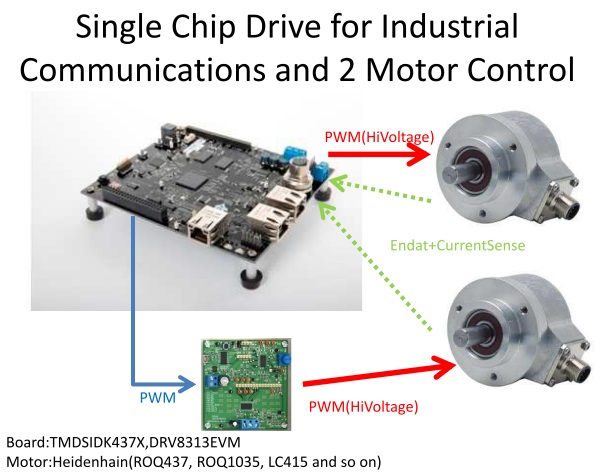

  • afzal-san
    Thank you for reply.
    It seems that the AM437x can contorl 2 motors with DRV8313 and Endat.
    The evaluation environment is assumed by simple composition.
    Partial improvement is needed, but is there a better way about composition?
    (0ohm jumper resistor remove,ICSS connection and so on)
    best regards,
    kyt
  • Hi Kyt-san,
    1. If BLDC motor has to be run, relevant motor control algorithm has to be adapted for AM437x. FOC algorithm in IASDK is for PMSM (PM machine that would would give sine wave if run as generator, but for BLDC it would be trapezoidal)
    2. As only one onboard EnDat connector is available on AM437x IDK, external transceiver circuitry would be required to connect the second encoder (refer EnDat TI Design mentioned earlier in this thread) - this can connected via expansion connector J16 (refer schematics)
    3. DRV8313EVM require 3 PWM signals & 3 control signals - these can be taken out from expansion connector J16
    4. As it is BLDC, seems only one current sense per motor-drive set would be sufficient. And in the current implementation, 2 phase current is being monitored, 1 out of these ADC input signal instead can be connected to DRV8313EVM for current sense via expansion connector J1, so that current sense on both motor-drive set can be achieved with minimal changes.
    afzal
