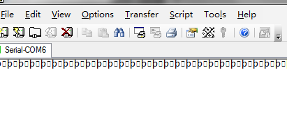

3.the data print through the serial port is random.
