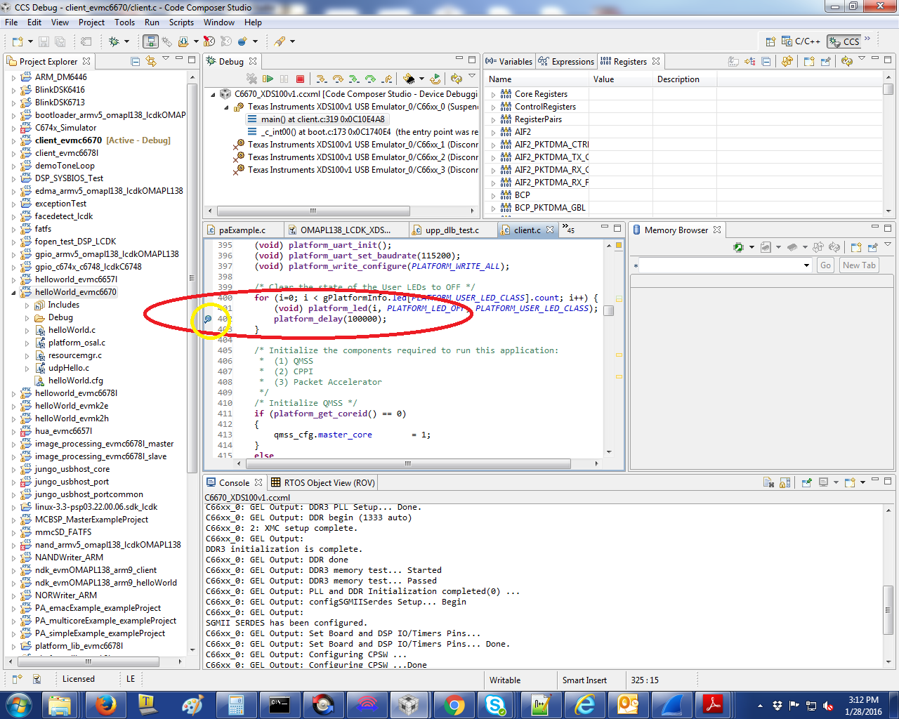

  • Dear Taras,
    F.E., i have 2 functions - "platform_init", which is a standart platform lib function i can't step into and trace the execution, and "platform_initialization", which is written by me, but that's a full copy of "platform_init", i made it to step-by-step tracing execution. And i've inserted the most functions into program text, due to easy tracing process. When i launch program, with using standart library functions, i recieve the correct register and delay values. And, for some reason, using "handmade" functions leading to correct register, but incorrect delay values.
    After that, i've tryed to load both programs through ethernet, to initialize DDR. Both of them load correctly, and when, after that, i'm loading program in DDR, which also uses delay, it works correctly after both kind of initialization. I was ok to me, but now it's very important to me to make the "handmade" program work correctly.
    You can also debug the platform libraries (any library which linked into project) like step into, step over etc., but you need to have that source code on your computer (any way we have that library now)
    When your program counter hits the "platform_init" function then you please press "F5" for step into debugging and throws error "source file location not find" or something like that then you need to give the location of the source file like below.
    C:\ti\pdk_C6670_1_1_2_6\packages\ti\platform\evmc6670l\platform_lib\src
    Please refer the screen shots.
