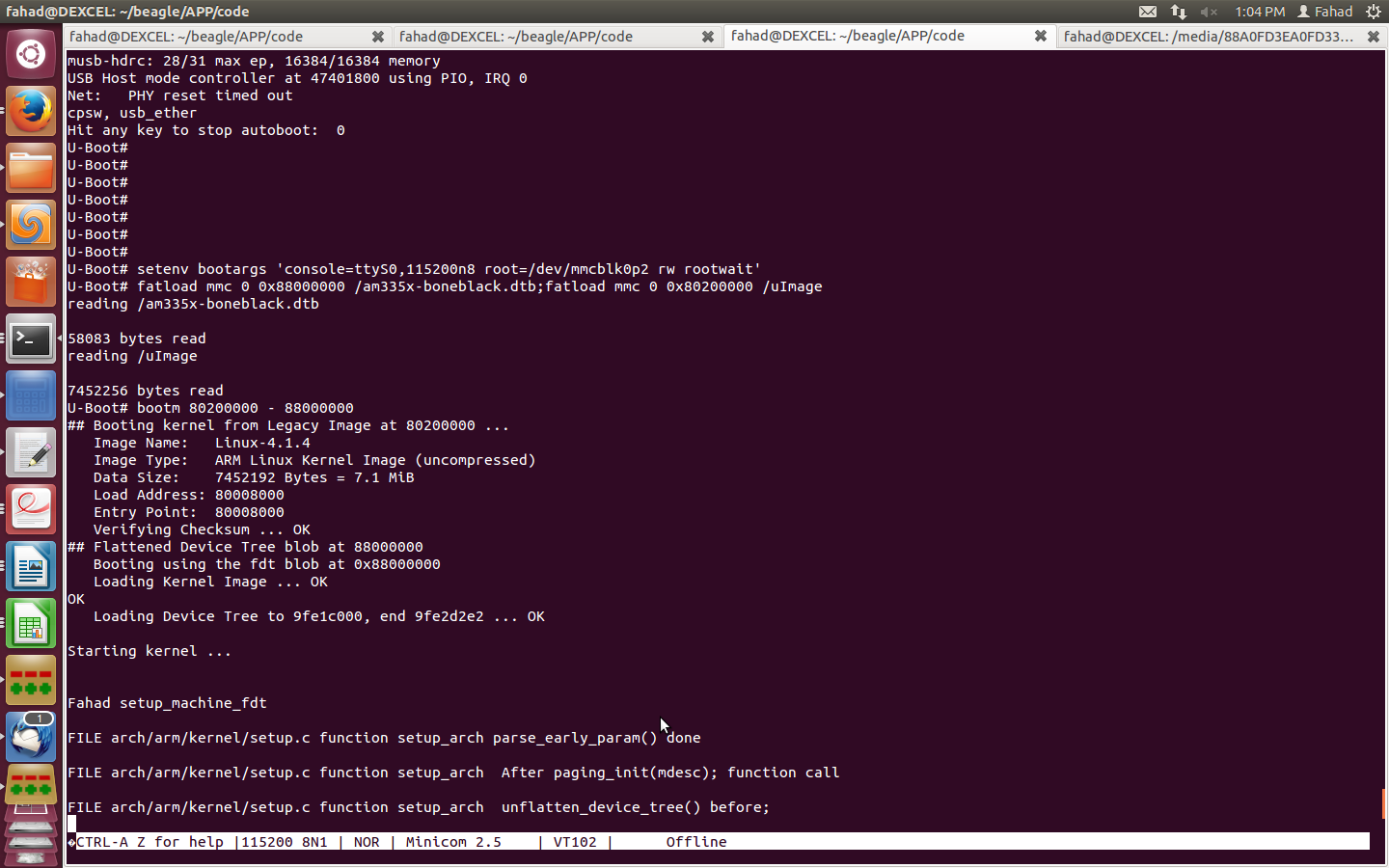

AM3352BZCEA60 DDR3 IS43TR16256AL-15HBL crash after kernel paging init
while trying to boot AM3352BZCEA60 DDR3 IS43TR16256AL-15HBL one our custom board. we are facing issue in bootup
we used
u-boot from arago repository
arago-project.org/.../
And kernel from that is latest supplied by through beaglebone Angstrom website. kernel 4.1.4
U-Boot# bootm 80200000 - 88000000
## Booting kernel from Legacy Image at 80200000 ...
   Image Name:   Linux-4.1.4
   Image Type:   ARM Linux Kernel Image (uncompressed)
   Data Size:    7452192 Bytes = 7.1 MiB
   Load Address: 80008000
   Entry Point:  80008000
   Verifying Checksum ... OK
## Flattened Device Tree blob at 88000000
   Booting using the fdt blob at 0x88000000
   Loading Kernel Image ... OK
OK
   Loading Device Tree to 9fe1c000, end 9fe2d2e2 ... OK
Starting kernel ...

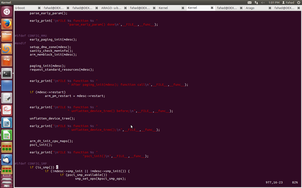

FILE arch/arm/kernel/setup.c function setup_arch parse_early_param() done
FILE arch/arm/kernel/setup.c function setup_arch  After paging_init(mdesc); function call
FILE arch/arm/kernel/setup.c function setup_arch  unflatten_device_tree() before;
No response from device after this print
We have modified slightly in u-boot according to our DDR3L values

We can see u-boot boots up after loading the kernel and after paging initialization the kernel crashed in unflatten_device_tree() before; function
    You must configure your DDR memory first, following these guides:
    processors.wiki.ti.com/.../AM335x_EMIF_Configuration_tips
    processors.wiki.ti.com/.../AM335x_DDR_PHY_register_configuration_for_DDR3_using_Software_Leveling
    Please note that this forum supports only the TI distributed Linux SDK. We do not support the Angstrom build.

  • I strongly recommend you use the latest Linux SDK, which can be downloaded from here: software-dl.ti.com/.../index_FDS.html The kernel version you use is not supported by TI.
  • First, I agree with Biser's comments that you would be well-advised to migrate to a newer version of Linux and u-boot.  There are many MANY issues that have been solved in the years since those were released, and inevitably you will be re-solving all those same issues unless you move to something newer.
    Umakanta Patro1 said:
    Enter the PHY_INVERT_CLKOUT value (0 or 1) from the spreadsheet
    1
    Usually in designs using INVERT_CLKOUT=1 you need to increase the value of DDR_PHY_CTRL_1 (@0x4C0000E4) REG_READ_LATENCY.  That might be your issue.
    I was also going to tell you to be sure and run the software leveling though there are some bugs in those older u-boot versions which might make it not work right.  Please update to a newer version.
  • Thanks Brad and Biser for your suggestions.
    We are trying to download TI AM335 SDK and build and use the U-boot and kernel from it for our board.
    Meanwhile, If you could help us in understanding what is wrong with our process/calculation because of which we find 0x00 as the optimized values for SW leveling on our board, that would be helpful.  Also, we would like to know whether 0x00 as optimized value is a valid value to be used in our GEL file and U-boot source.
    We are attaching the log from our SW leveling again:
    [CortxA8]
    1
    Enter the Seed RD_DQS_SLAVE_RATIO Value in Hex to search the RD DQS Ratio Window
    40
    Enter the Seed FIFO_WE_SLAVE_RATIO Value in Hex to search the RD DQS Gate Window
    E7
    Enter the Seed WR_DQS_SLAVE_RATIO Write DQS Ratio Value in Hex to search the Write DQS Ratio Window
    7F
    The Slave Ratio Search Program Values are...
    PARAMETER                       MAX  |  MIN  | OPTIMUM |  RANGE
    DATA_PHY_RD_DQS_SLAVE_RATIO    0x000 | 0x000 |  0x000  | 0x000
    DATA_PHY_FIFO_WE_SLAVE_RATIO   0x000 | 0x000 |  0x000  | 0x000
    DATA_PHY_WR_DQS_SLAVE_RATIO    0x000 | 0x000 |  0x000  | 0x000
    DATA_PHY_WR_DATA_SLAVE_RATIO   0x000 | 0x000 |  0x000  | 0x000
    rd_dqs_range = 0
    fifo_we_range = 0
    wr_dqs_range = 0
    wr_data_range = 0
    Optimal values have been found!!
    END OF TEST
    Umakanta
  • Did you increase REG_READ_LATENCY per my previous reply?
