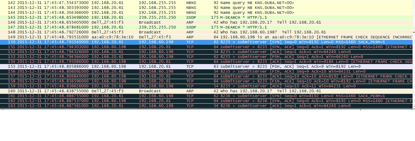

1. PC IP addr : 192,168,20.45 ,Subnet mask : 255.255.0.0.
2. Embedded devices  IP addr : 192.168.60.198, Subnet mask : 255.255.255.0,this Embedded devices using NDK module,we hypothesis it's Dev 1 at here.
3. Dev 1 as service ,and PC as client( common network tools on pc)
4.by using network tools ,I find PC  can communication with Dev 1, just I don't know that's why,can you tell me?

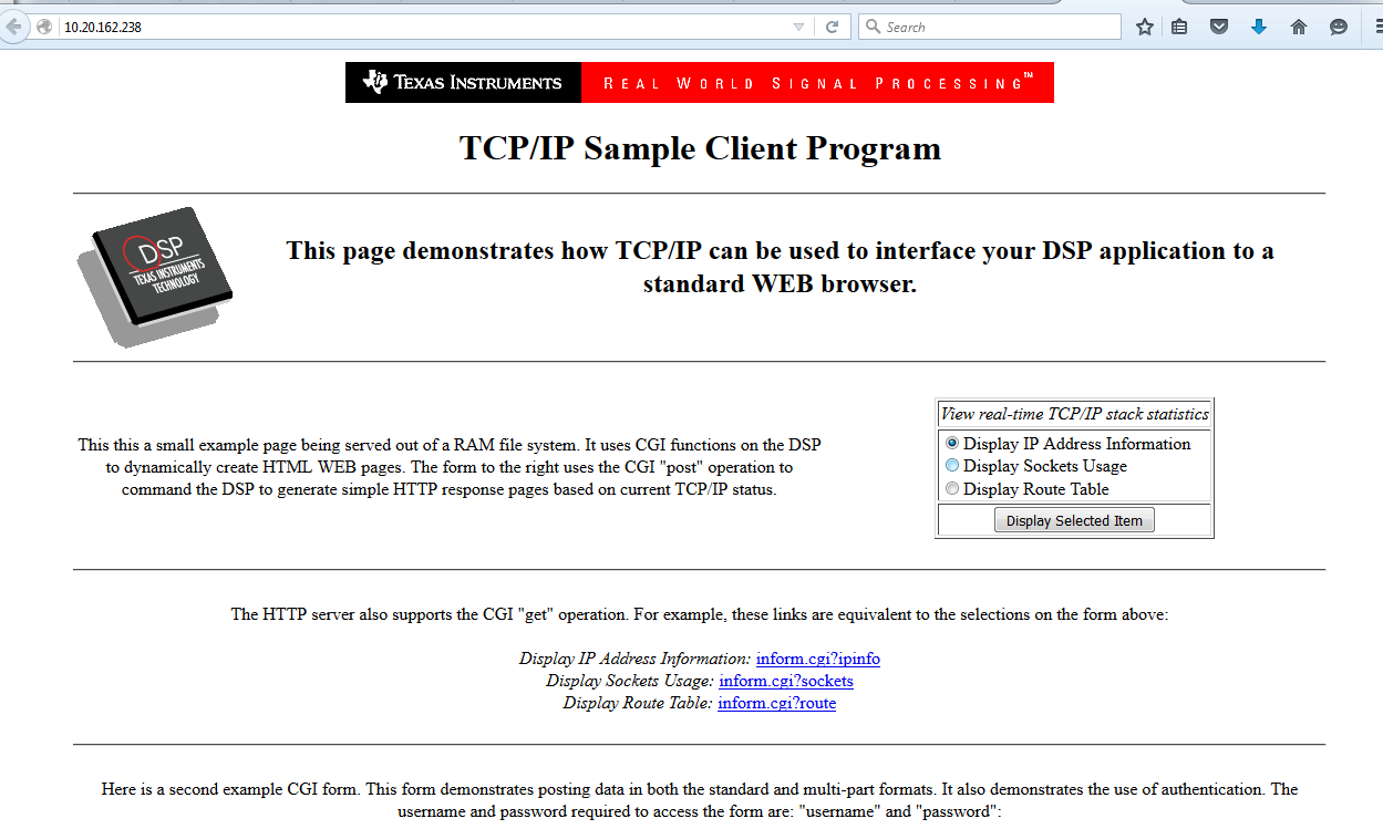

    By using the following example, you can open the webpage with the OMAPL138 IP address.( 10.20.162.238)
    ~\ti\nsp_1_10_02_09\packages\ti\ndk\examples\ndk_evmOMAPL138_arm9_client
    The following console log which I got.

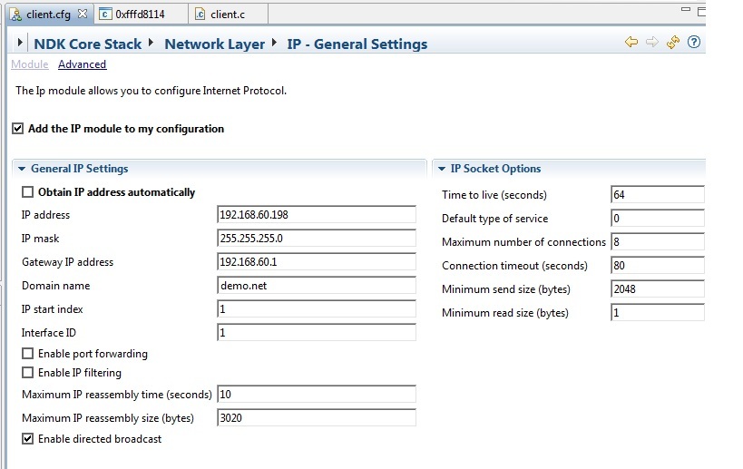

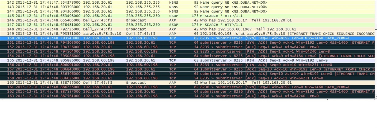

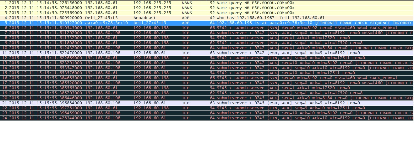

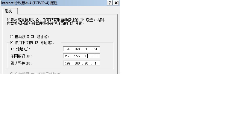

  • Hi Shankari G,
    my pc network settings
    examples cfg file settings
    thanks for you help again!
  • Dear Community Member,
    In my understanding, different gateway is used in your IP settings.
    Can you please try this way ?
    PC's IP : 192.168.20.61, IP mask: 255.255.255.0, Gateway IP: 192.168.20.1
    OMAPL138's IP : 192.168.20.70, IP mask: 255.255.255.0, Gateway IP: 192.168.20.1
    Please maintain one gateway either 192.168.60.1 or 192.168.20.1.
