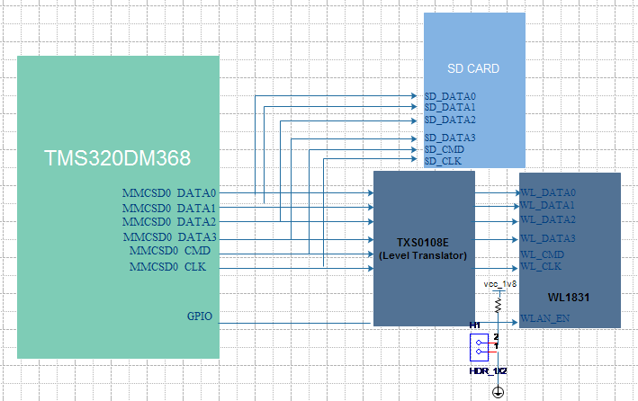

We are using TMS320DM368 and planning to use SDIO interface on “SD0” for initial programming from Sd card as well as streaming over wifi (WL1831).
Can I use same SDIO interface for both. At the time of initial programming we will disable the WLAN_EN pin of (Wilink WL1831) using external jumper.
Please confirm, can we do like this way. For your reference please refer attached image.
