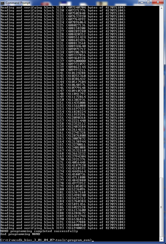

kernel stuck at keystone-netcp 2090000.netcp: dma_chan_name nettx1
I am using evm and this the issue that I have been facing after programing the nand and nor through this link.
http://processors.wiki.ti.com/index.php/Program_EVM_UG
seems like some issue with either USB or ethernet. How can I solve it?
Also I would like to ask how could I bypaas ethernet and USB interafce in kernel?
here is the log:

[   16.577953] hw perfevents: enabled with ARMv7 Cortex-A15 PMU driver, 7 counters available
[   16.637761] bounce pool size: 64 pages
[   16.644460] Installing knfsd (copyright (C) 1996 okir@monad.swb.de).
[   16.644605] NTFS driver 2.1.30 [Flags: R/O].
[   16.644806] jffs2: version 2.2. (NAND) © 2001-2006 Red Hat, Inc.
[   16.645060] msgmni has been set to 1478
[   16.645735] NET: Registered protocol family 38
[   16.646196] Block layer SCSI generic (bsg) driver version 0.4 loaded (major 252)
[   16.646202] io scheduler noop registered
[   16.646206] io scheduler deadline registered
[   16.646315] io scheduler cfq registered (default)
[   16.647222] keystone-udma udma0.5: registered udma device udma0
[   16.681999] Serial: 8250/16550 driver, 4 ports, IRQ sharing disabled
[   16.683013] 2530c00.serial: ttyS0 at MMIO 0x2530c00 (irq = 309) is a 16550A
[   17.350705] console [ttyS0] enabled
[   17.353975] 2531000.serial: ttyS1 at MMIO 0x2531000 (irq = 312) is a 16550A
[   17.361770] loop: module loaded
[   17.364443] at24 0-0050: 131072 byte 24c1024 EEPROM, writable, 1 bytes/write
[   17.370789] Generic platform RAM MTD, (c) 2004 Simtec Electronics
[   17.376452] ONFI param page 0 valid
[   17.379302] ONFI flash detected
[   17.381867] NAND device: Manufacturer ID: 0x2c, Chip ID: 0xac (Micron MT29F4G08ABBDAHC), 512MiB, page size: 2048, OOB size: 64
[   17.391384] Bad block table found at page 262080, version 0x01
[   17.396470] Bad block table found at page 262016, version 0x01
[   17.401449] 3 ofpart partitions found on MTD device 30000000.nand
[   17.406427] Creating 3 MTD partitions on "30000000.nand":
[   17.410845] 0x000000000000-0x000000100000 : "u-boot"
[   17.415347] 0x000000100000-0x000000180000 : "params"
[   17.419837] 0x000000180000-0x000020000000 : "ubifs"
[   17.424924] davinci_nand 30000000.nand: controller rev. 2.5
[   17.429936] spi_davinci 21000400.spi: master is unqueued, this is deprecated
[   17.435914] m25p80 spi32766.0: found n25q128a11, expected n25q128
[   17.440903] m25p80 spi32766.0: n25q128a11 (16384 Kbytes)
[   17.445249] 2 ofpart partitions found on MTD device spi32766.0
[   17.450019] Creating 2 MTD partitions on "spi32766.0":
[   17.454217] 0x000000000000-0x000000080000 : "u-boot-spl"
[   17.458975] 0x000000080000-0x000001000000 : "test"
[   17.463527] spi_davinci 21000400.spi: Controller at 0xf0078400
[   17.468539] spi_davinci 21000600.spi: master is unqueued, this is deprecated
[   17.474312] spi_davinci 21000600.spi: Controller at 0xf007a600
[   17.479316] spi_davinci 21000800.spi: master is unqueued, this is deprecated
[   17.485085] spi_davinci 21000800.spi: Controller at 0xf007c800
[   17.490597] libphy: GPIO Bitbanged MDIO: probed
[   17.494889] mdio_bus gpio-ffffffed: cannot get PHY at address 0
[   17.500320] mdio_bus gpio-ffffffed: cannot get PHY at address 1
[   17.505215] tun: Universal TUN/TAP device driver, 1.6
[   17.509348] tun: (C) 1999-2004 Max Krasnyansky <maxk@qualcomm.com>
[   17.514747] keystone-netcp 2f00000.netcp: No streaming regs defined
[   17.519937] keystone-netcp 2090000.netcp: cpts rftclk freq not defined
[   17.525312] netif_napi_add() called with weight 128 on device eth%d
[   17.531087] keystone-netcp 2090000.netcp: Created interface "eth0"
[   17.536142] keystone-netcp 2090000.netcp: dma_chan_name nettx0
[   17.541556] keystone-netcp 2090000.netcp: Created interface "eth1"
[   17.546612] keystone-netcp 2090000.netcp: dma_chan_name nettx1
[   34.774749] INFO: rcu_sched self-detected stall on CPU { 3}  (t=2101 jiffies g=4294967012 c=4294967011 q=80)
[   34.782802] CPU: 3 PID: 1 Comm: swapper/0 Not tainted 3.10.10 #1
[   34.782949] INFO: rcu_sched detected stalls on CPUs/tasks: { 3} (detected by 1, t=2102 jiffies, g=4294967012, c=4294967011, q=80)
[   34.782951] Task dump for CPU 3:
[   34.782956] swapper/0       R running      0     1      0 0x00000002
[   34.782973] [<c05043b8>] (__schedule+0x1f8/0x61c) from [<c0501f98>] (dump_stack+0xc/0x20)
[   34.782982] [<c0501f98>] (dump_stack+0xc/0x20) from [<c00733e0>] (rcu_check_callbacks+0x348/0x7c0)
[   34.782992] [<c00733e0>] (rcu_check_callbacks+0x348/0x7c0) from [<c002faf4>] (update_process_times+0x38/0x64)
[   34.783003] [<c002faf4>] (update_process_times+0x38/0x64) from [<c0060030>] (tick_sched_timer+0x64/0x1cc)
[   34.783010] [<c0060030>] (tick_sched_timer+0x64/0x1cc) from [<c004396c>] (__run_hrtimer+0x78/0x1a8)
[   34.783015] [<c004396c>] (__run_hrtimer+0x78/0x1a8) from [<c00442a8>] (hrtimer_interrupt+0x110/0x2c4)
[   34.783022] [<c00442a8>] (hrtimer_interrupt+0x110/0x2c4) from [<c036e650>] (arch_timer_handler_phys+0x28/0x30)
[   34.783029] [<c036e650>] (arch_timer_handler_phys+0x28/0x30) from [<c006ea34>] (handle_percpu_devid_irq+0x78/0x114)
[   34.783036] [<c006ea34>] (handle_percpu_devid_irq+0x78/0x114) from [<c006b350>] (generic_handle_irq+0x20/0x30)
[   34.783046] [<c006b350>] (generic_handle_irq+0x20/0x30) from [<c000e974>] (handle_IRQ+0x38/0x94)
[   34.783051] [<c000e974>] (handle_IRQ+0x38/0x94) from [<c0008520>] (gic_handle_irq+0x28/0x5c)
[   34.783058] [<c0008520>] (gic_handle_irq+0x28/0x5c) from [<c05059c0>] (__irq_svc+0x40/0x50)
[   34.783060] Exception stack(0xee0b9e30 to 0xee0b9e78)
[   34.783063] 9e20:
