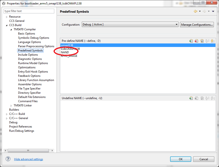

  • Hi william,
    Please make sure that you have defined  "NAND" in "CCS Predefined symbol"

  • EDIT: I have a TMDSEVML138-B from LogicPD. It does have parallel NOR flash on the daughter card. I am able to successfully burn to it and boot from it with their examples. Your example here is much more sophisticated so I would like to learn to use it in NAND and NOR.

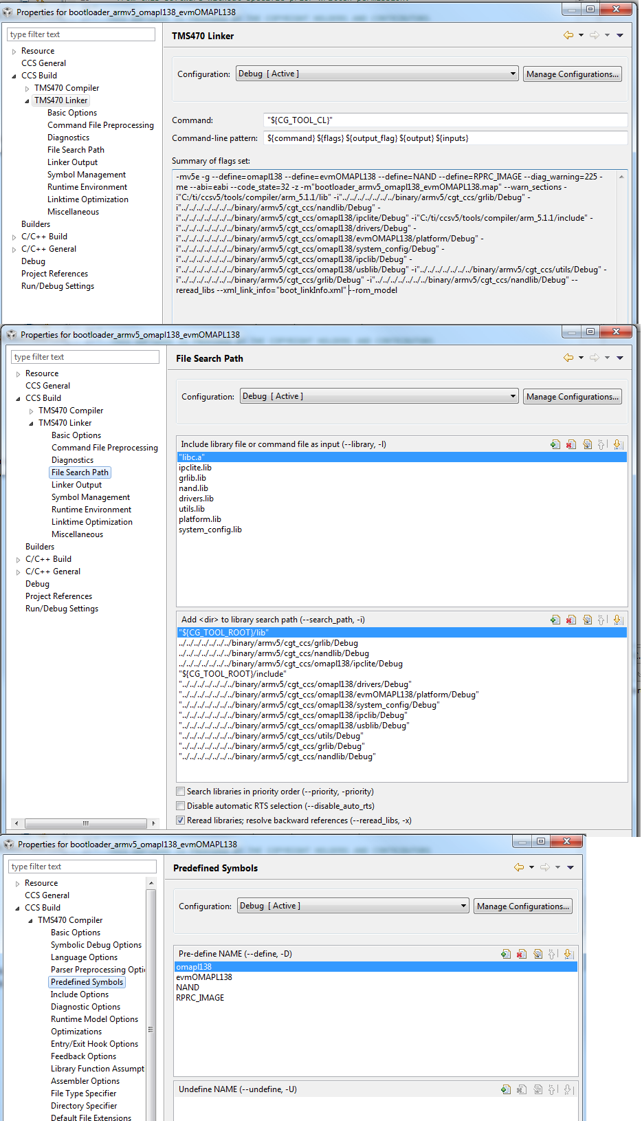

    I do have that defined. Here is my build output:
    **** Build of configuration Debug for project bootloader_armv5_omapl138_evmOMAPL138 ****
    "C:\\ti\\ccsv5\\utils\\bin\\gmake" -k all
    'Building file: C:/ti/OMAPL138_StarterWare_1_10_03_03/bootloader/src/bl_copy_rprc.c'
    'Invoking: TMS470 Compiler'
    "C:/ti/ccsv5/tools/compiler/arm_5.1.1/bin/armcl" -mv5e -g --define=omapl138 --define=evmOMAPL138 --define=NAND --define=RPRC_IMAGE --include_path="C:/ti/ccsv5/tools/compiler/arm_5.1.1/include" --include_path="../../../../../../../include" --include_path="../../../../../../../bootloader/include" --include_path="../../../../../../../bootloader/include/evmOMAPL138" --include_path="../../../../../../../include/hw" --include_path="../../../../../../../include/armv5" --include_path="../../../../../../../include/armv5/omapl138" --include_path="../../../../../../../grlib/include" --include_path="../../../../../../../usblib/include" --include_path="../../../../../../../ipclite/include" --include_path="../../../../../../../nandlib/include" --diag_warning=225 -me --abi=eabi --code_state=32 --preproc_with_compile --preproc_dependency="bl_copy_rprc.pp" "C:/ti/OMAPL138_StarterWare_1_10_03_03/bootloader/src/bl_copy_rprc.c"
    'Finished building: C:/ti/OMAPL138_StarterWare_1_10_03_03/bootloader/src/bl_copy_rprc.c'
    'Building file: C:/ti/OMAPL138_StarterWare_1_10_03_03/bootloader/src/bl_main.c'
    "C:/ti/ccsv5/tools/compiler/arm_5.1.1/bin/armcl" -mv5e -g --define=omapl138 --define=evmOMAPL138 --define=NAND --define=RPRC_IMAGE --include_path="C:/ti/ccsv5/tools/compiler/arm_5.1.1/include" --include_path="../../../../../../../include" --include_path="../../../../../../../bootloader/include" --include_path="../../../../../../../bootloader/include/evmOMAPL138" --include_path="../../../../../../../include/hw" --include_path="../../../../../../../include/armv5" --include_path="../../../../../../../include/armv5/omapl138" --include_path="../../../../../../../grlib/include" --include_path="../../../../../../../usblib/include" --include_path="../../../../../../../ipclite/include" --include_path="../../../../../../../nandlib/include" --diag_warning=225 -me --abi=eabi --code_state=32 --preproc_with_compile --preproc_dependency="bl_main.pp" "C:/ti/OMAPL138_StarterWare_1_10_03_03/bootloader/src/bl_main.c"
    'Finished building: C:/ti/OMAPL138_StarterWare_1_10_03_03/bootloader/src/bl_main.c'
    'Building file: C:/ti/OMAPL138_StarterWare_1_10_03_03/bootloader/src/evmOMAPL138/bl_platform.c'
    "C:/ti/ccsv5/tools/compiler/arm_5.1.1/bin/armcl" -mv5e -g --define=omapl138 --define=evmOMAPL138 --define=NAND --define=RPRC_IMAGE --include_path="C:/ti/ccsv5/tools/compiler/arm_5.1.1/include" --include_path="../../../../../../../include" --include_path="../../../../../../../bootloader/include" --include_path="../../../../../../../bootloader/include/evmOMAPL138" --include_path="../../../../../../../include/hw" --include_path="../../../../../../../include/armv5" --include_path="../../../../../../../include/armv5/omapl138" --include_path="../../../../../../../grlib/include" --include_path="../../../../../../../usblib/include" --include_path="../../../../../../../ipclite/include" --include_path="../../../../../../../nandlib/include" --diag_warning=225 -me --abi=eabi --code_state=32 --preproc_with_compile --preproc_dependency="bl_platform.pp" "C:/ti/OMAPL138_StarterWare_1_10_03_03/bootloader/src/evmOMAPL138/bl_platform.c"
    'Finished building: C:/ti/OMAPL138_StarterWare_1_10_03_03/bootloader/src/evmOMAPL138/bl_platform.c'
    'Building target: boot.out'
    'Invoking: TMS470 Linker'
    "C:/ti/ccsv5/tools/compiler/arm_5.1.1/bin/armcl" -mv5e -g --define=omapl138 --define=evmOMAPL138 --define=NAND --define=RPRC_IMAGE --diag_warning=225 -me --abi=eabi --code_state=32 -z -m"bootloader_armv5_omapl138_evmOMAPL138.map" --warn_sections -i"C:/ti/ccsv5/tools/compiler/arm_5.1.1/lib" -i"../../../../../../../binary/armv5/cgt_ccs/grlib/Debug" -i"../../../../../../../binary/armv5/cgt_ccs/nandlib/Debug" -i"../../../../../../../binary/armv5/cgt_ccs/omapl138/ipclite/Debug" -i"C:/ti/ccsv5/tools/compiler/arm_5.1.1/include" -i"../../../../../../../binary/armv5/cgt_ccs/omapl138/drivers/Debug" -i"../../../../../../../binary/armv5/cgt_ccs/omapl138/evmOMAPL138/platform/Debug" -i"../../../../../../../binary/armv5/cgt_ccs/omapl138/system_config/Debug" -i"../../../../../../../binary/armv5/cgt_ccs/omapl138/ipclib/Debug" -i"../../../../../../../binary/armv5/cgt_ccs/omapl138/usblib/Debug" -i"../../../../../../../binary/armv5/cgt_ccs/utils/Debug" -i"../../../../../../../binary/armv5/cgt_ccs/grlib/Debug" -i"../../../../../../../binary/armv5/cgt_ccs/nandlib/Debug" --reread_libs --xml_link_info="boot_linkInfo.xml" --rom_model -o "boot.out" "./bl_platform.obj" "./bl_main.obj" "./bl_copy_rprc.obj" "../boot.cmd" -l"libc.a" -lipclite.lib -lgrlib.lib -lnand.lib -ldrivers.lib -lutils.lib -lplatform.lib -lsystem_config.lib
    <Linking>
    undefined first referenced
    symbol in file
    BL_NAND_Configure ./bl_copy_rprc.obj
    BL_NAND_ReadFlash ./bl_copy_rprc.obj
    error: unresolved symbols remain
    error: errors encountered during linking; "boot.out" not built
    >> Compilation failure
    gmake: *** [boot.out] Error 1
    gmake: Target `all' not remade because of errors.
    **** Build Finished ****

  • Hi william,
    I'm able to build the EVM based starterware bootloader for NAND flash.
    What is your starterware version ?
    I have "BlNANDConfigure()" line in "bl_copy_rprc.c" file but your project has some different name "BL_NAND_Configure"
    C:\ti\OMAPL138_StarterWare_1_10_04_01\build\armv5\cgt_ccs\omapl138\evmOMAPL138\bootloader
    Also, I found one more issue in your project; that is, you have to add the "bl_nand.c" source code into your bootloader project to resolve the "BL_NAND_Configure" linking problem.
    Then, you will be able to build the bootloader without any issue.
