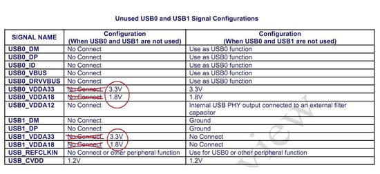

Hello
Our device have USB0, USB1 and SATA but we don't want to use their (we don't want mounting elements on PCB). Below there are lists of pins configuration.
Can USB0_VDDA33, USB0_VDDA18, USB1_VDDA33, USB1_VDDA18 and SATA_VDDR still be supplied when other pins are like below.
