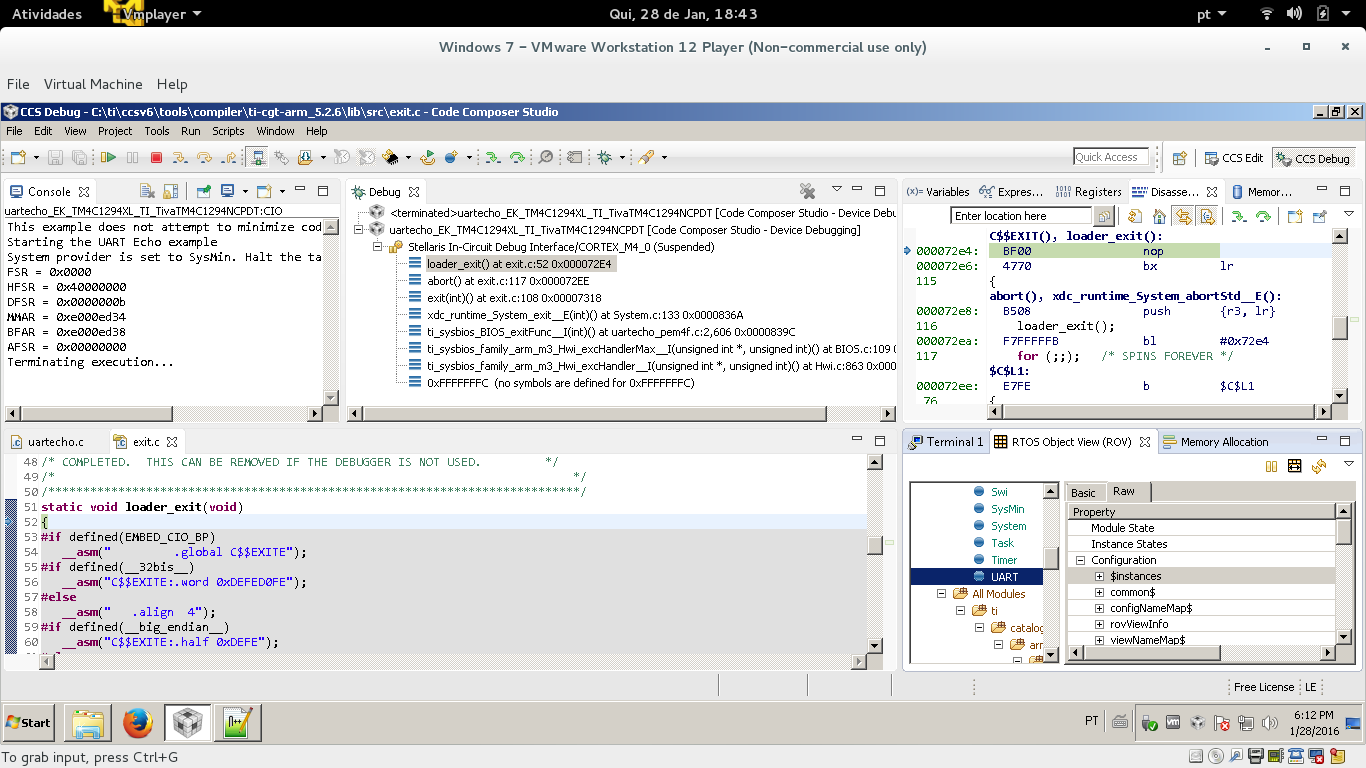

Bu don't work, here is the error:
What am I forgetting?
