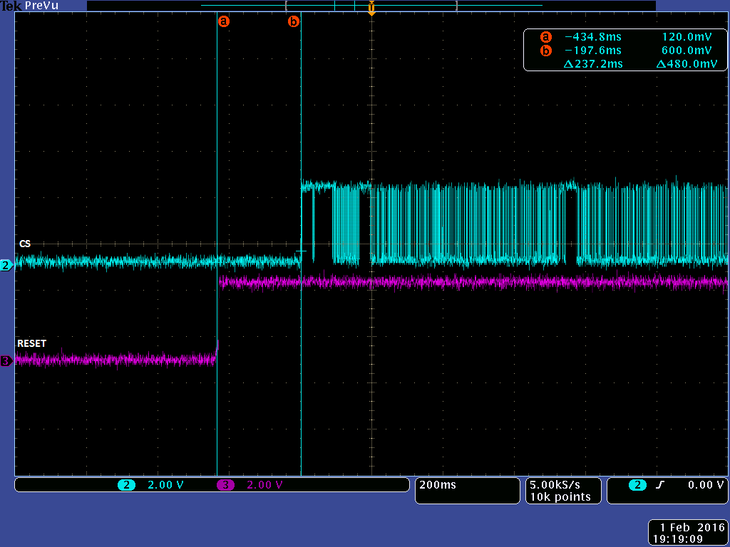

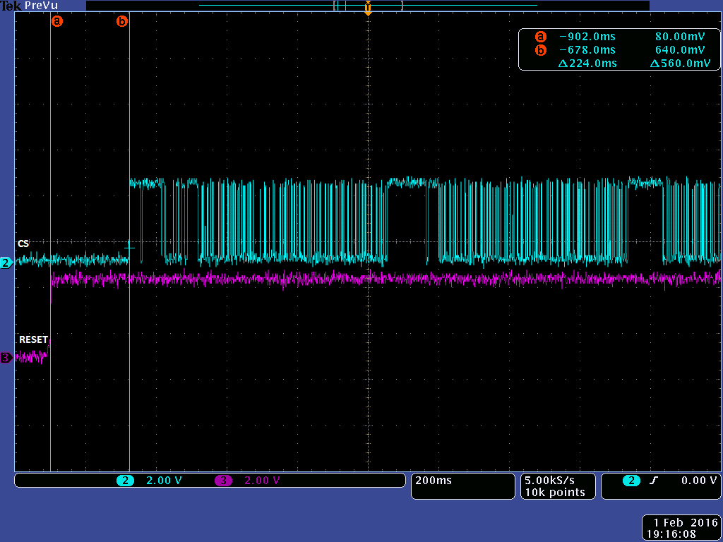

    Please find the waveforms of Nand flash CS and RST respectively for working and not working board
    Working Board :
    Not Working board :

  • Vijay,
    I see you have verified all the possible things. However i would like to know if these are verified when the board is not booting properly ?
    Have you tried swap the device between working and not working board ?
    Senthil
  • Senthil,
    I have verified all the possibilities when board is not booting properly and waveforms cross verified with  working board and also compared with same board second time power ON / reset both the conditions.
    When we changed the processor on one of the reset issue board then it's booting at first time power on, we have checked for consistency found to be OK.
    But we are trying to analysis the root cause for the issue.Out of 100 boards 6 boards are having same issue.
    Vijay Varma
