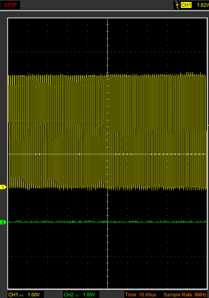

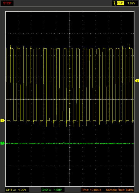

    They found MDIO clock was different between U-Boot and Kernel as below, and are thinking they should block gigabit setting in the kernel as their PHY is 10/100, but couldn't. Could you please check if there is additional checked for 10/100 PHY in Kernel?
    UBOOT:
    Kernel :
