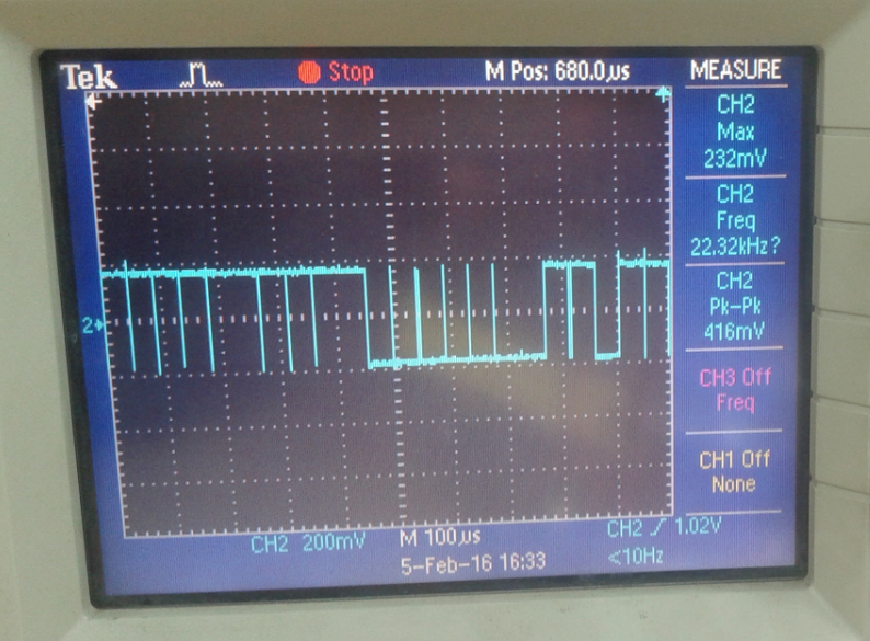

I am trying to play stereo audio file (Signed 16 bit Little endian, Rate 22050 Hz, Stereo) with TLV320DAC3100 with AM335x Processor using McASP1.
I have configured Codec as a Bit clock Master and Frame clock Master(SND_SOC_DAIFMT_CBM_CFM).
McASP1 MCLK = 24Mhz.
I got BCLK = 704Khz and WCLK = 22Khz but I am getting Noisy output of my audio file.
My McASP1 pin muxing are as shown below
 mcasp1_pins: mcasp1_pins {
                pinctrl-single,pins = <
                        0x140 (PIN_OUTPUT_PULLUP  | MUX_MODE3)            /* P18 mii1_rxd0.mcasp1_ahclkx AUD_MCLK */
                        0x110 (PIN_INPUT  | MUX_MODE4)                                /* K19 mii1_rxerr.mcasp1_fsx AUD_FSX */
                        0x10C (PIN_INPUT | MUX_MODE4)                                /* J18 mii1_crs.mcasp1_aclkx AUD_BCLK */
                        0x108 (PIN_OUTPUT_PULLDOWN | MUX_MODE4)      /* J19 mii1_col.mcasp1_axr2 AUD_DIN */
Waveform of Noise on DIN pin of McASP
I have attached codec and McASP source files.
Please provide appropriate solution. waiting for your response.
kishan
