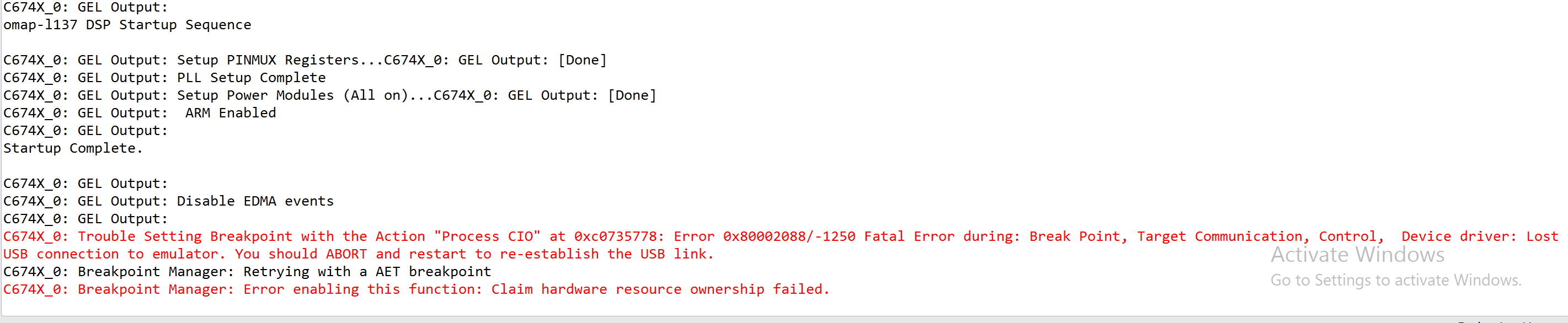

I am loading a code done by a colleague of mine. The code builds and loads ok using her environment. When I try to build and load to the target OMAP L 137 board the load fails with the following message. We are only using the DSP (C6747) but the ARM.
Here is the error message I get "Trouble Setting Breakpoint with the Action "Process CIO" at 0xc1735778: Error 0x80002088/-1250 Fatal Error during: Break Point, Target Communication, Control,  Device driver: Lost USB connection to emulator. You should ABORT and restart to re-establish the USB link. ". It is shown in the screen capture below.
There is a similar post previously which points to a memory map issue. However I think I am using the correct GET file and .tcf files. Any help in debugging the issue is greatly appreciated!

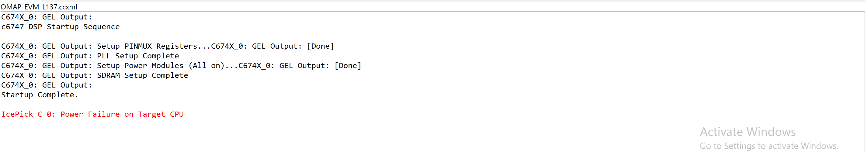

    I tried to launch the target configuration and then tried to connect using "Run->connect". I get the following error message after lading the GEL files.

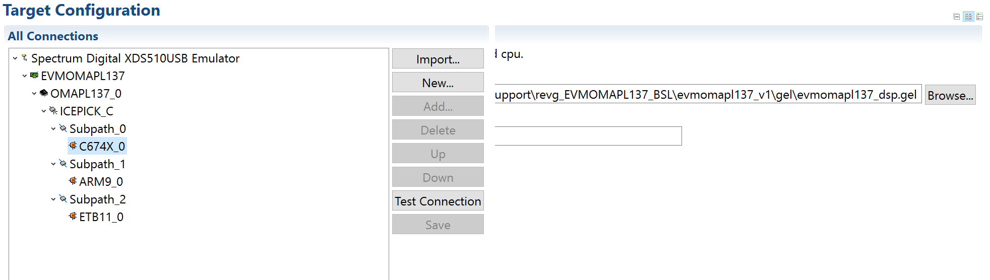

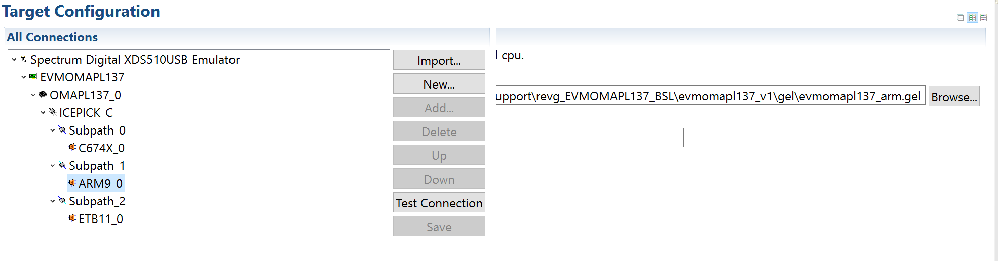

    I tired using different target configurations which contains single GEL file for C6747 as well as two GEL files for C6747and ARM. See below for the target configurations. I get the same error for both of the target configurations. So I could not try loading .out file. Looks like the issue is not in the build output?
