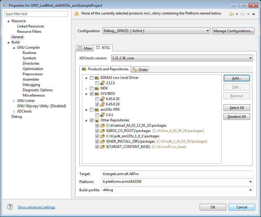

  • Hi, Lali!
    Sorry for the delay getting back to you.  I hadn't realized I had an answer here waiting for me.
    What's odd about attempting to do this is that after a few days ago (possibly coinciding with what appears to be an automatic update to several versions of XDSTOOLS, and possibly with my having gone through the example-build batch files from above), EDMA3, NDK and the PDK is showing as NOT being installed in CCS.  And when I go to  Window>preferences>Code Composer Studio>RTSC>Products  and then [Install New...] and selecting the directory (e.g. c:\ti\pdk_am335x_1_0_1), there is a quick flash and then nothing new is installed!  I attached a 3-second video showing this.
    Simultaneously, I have tried building other projects, and am now running into a new set of errors (e.g. for the UART_BasicExample_evmAM335x_armExampleProject   project for the evmAM335x board):
    Description    Resource    Path    Location    Type
    Product 'am335x PDK' v1.0.1 is not currently installed and no compatible version is available. Please install this product or a compatible version.    UART_BasicExample_evmAM335x_armExampleProject        UART_BasicExample_evmAM335x_armExampleProject    Problems
    Product 'EDMA3 Low Level Driver' v2.12.1 is not currently installed and no compatible version is available. Please install this product or a compatible version.    UART_BasicExample_evmAM335x_armExampleProject        UART_BasicExample_evmAM335x_armExampleProject    Problems
    Product 'NDK' v2.24.3.35 is not currently installed and no compatible version is available. Please install this product or a compatible version.    UART_BasicExample_evmAM335x_armExampleProject        UART_BasicExample_evmAM335x_armExampleProject    Problems
    This screenshot of the Project Properties window shows red "X's" next to these products.  Yet I didn't de-install them (they were installed successfully with the PDK and I was working with the examples as above), and this set of errors started appearing just after the XDCTOOLS updates.
    Yet, this directory tree shows the fact of them having been installed.  The red arrows show the products that were installed with the PDK.
    Help!  :-(

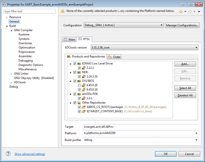

  • Hi, Lali!
    Okay, well with a tip from a fellow by the name of Chester Gillon, I resolved PART of the above.  Specifically,
    1.  CCS > Help > About Code Composer Studio > Installation Details.  I selected (one at a time, though it may be possible to do this in a group as well, not sure yet):  am335x PDK, NDK (IDE Client), NDK (Target Client), and EDMA3 and uninstalled them.  I answered YES to re-starte CCS between each one except for the two NDK items, which I did back to back and then accepted the re-start.
    2.  CCS > Window > Preferences > Code Composer Studio > RTSC > Products > Installed Products:  > [Install New...] button, and then I selected the already-existing directories for the above, namely:
      c:\ti\ndk_2_24_03_35
      c:\ti\edma3_lld_02_12_01_22
    one at a time, re-starting CCS between each one.
    Now my Project Properties look like this:
    However, now I have a new set of errors, and I believe we're getting back to the first set above.  Copy/paste of the errors and warnings:
    gmake: *** [configPkg/linker.cmd] Error 1    UART_BasicExample_evmAM335x_armExampleProject             C/C++ Problem
    gmake: Target `all' not remade because of errors.    UART_BasicExample_evmAM335x_armExampleProject             C/C++ Problem
    gmake.exe: *** No rule to make target `.configuro'.  Stop.    UART_BasicExample_evmAM335x_armExampleProject             C/C++ Problem
    template generation of 'compiler.opt' failed: Error: The compiler in C:/ti/ccsv6/tools/compiler/gcc-arm-none-eabi-4_8-2014q3 is not compatible with this version of TI-RTOS or SYS/BIOS. Please use Arm compiler 5.2.2 or newer.    .xdchelp    /UART_BasicExample_evmAM335x_armExampleProject    line 77    C/C++ Problem
    Product 'SYS/BIOS' v6.45.0.19 defines no repositories. Uninstall and reinstall the product, or contact the product provider.    UART_BasicExample_evmAM335x_armExampleProject        UART_BasicExample_evmAM335x_armExampleProject    Problems
    On a hunch, I tried the above steps with the SYS/BIOS v6.45.0.19, but doing so did not resolve the warning.
    I looked a bit into the 4th error above and found that it was a generated exception in the file C:\ti\bios_6_45_00_19\packages\ti\targets\arm\elf\IArm.xs  (Java?) as a result of the presence of file
        C:\ti\ccsv6\tools\compiler\ti-cgt-arm_15.12.0.LTS\bin\armcl.exe
    Back to the  GPIO_LedBlink_skAM335x_armExampleProject  project, I have virtually the same set of errors now as the above:

  • I tried deleting the GPIO_LedBlink_skAM335x_armExampleProject  (which I had imported into my workspace), as well as deleting the directory and all its contents from my workspace, and then I re-imported it from the source:
        C:\ti\pdk_am335x_1_0_1\packages\MyExampleProjects\GPIO_LedBlink_skAM335x_armExampleProject
    Yet, I still get the above errors and warnings.
    In case it is helpful, here is the screenshot showing the 2 unresolved variables, and I note that the variable EDMA3_LLD_INSTALL_DIR (for example) is neither in the LINKED nor the BUILD variable lists....  But it IS in the the path as shown in the screen shot.  But then, BIOS_CG_ROOT variable is ALSO not in the above 2 lists, but IT is resolved.  Where (and how) is the BIOS_CG_ROOT variable being generated?  Maybe that will give us a clue as to why EDMA3_LLD_INSTALL_DIR and the other one are not being resolved.  Perhaps they don't exist?  :-(
  • For what it's worth:  plugging in the hard-coded path for the 2 unresolved paths like this:
    now removed all but 1 warning.  All the errors are still present.  The one warning that remains is this one:
    Product 'SYS/BIOS' v6.45.0.19 defines no repositories. Uninstall and reinstall the product, or contact the product provider.    GPIO_LedBlink_skAM335x_armExampleProject        GPIO_LedBlink_skAM335x_armExampleProject    Problems
    ...and I do not know how to solve that (how to perform the uninstall step in a way that I haven't already tried -- I have tried the Help > About Code Composer Studio > Installation Details... > Select SYS/BIOS v6.45.0.19 > Uninstall, and then re-installing by Window > Preferences > Code Composer Studio > RTSC > Products > Install New... -- and these RAN and did not produce any errors, but still is not resolving the above warning).
    Is that last warning causing the errors?

  • Hi, Lali.
    Well, I FINALLY got something running.  I'll list here (while it is still fresh) the steps I went through to do so:
    1.  I deleted my imported   GPIO_LedBlink_skAM335x_armExampleProject   from within CCS (without deleting it on disk).
    2.  I closed CCS.
    3.  I manually deleted my directory for the same project in my workspace.
    4.  I manually deleted this directory:
    5.  I went into   C:\ti\pdk_am335x_1_0_1\packages   with a command prompt and ran:
    pdksetupenv.bat
    then
    pdkProjectCreate.bat   AM335x  skAM335x   little  gpio
    6.  I re-launched CCS and re-imported the project into CCS, checking both "Automatically import referenced projects found in same search-directory" and "Copy projects into workspace".  (I don't know if these checkboxes made any difference or not, but this is what worked, so I'm documenting the steps.)
    7.  I opened Project Properties and made the following changes:
    a.  Corrected Device from the erroneous "ICE_AM3359 [Cortex A]" to "SK_AM3358 [Cortex A]".
    b.  Set the "Connection" to "Texas Instruments XDS100v2 USB Debug Probe" (what's built into the Starter Kit board).
    c.  I noted that the compiler was "GNU v4.8.4 (Linaro)" and left it that way.  The linker command file (created during import?) is AM335x.lds.
    d.  Under the RTSC tab, I noted the XDCtools version was 3.31.2.38_core and I left it that way.
    e.  The following is what I had at this point:  Note that the SYS/BIOS selected (by project creation in step 5?) is v6.45.0.19 -- the version that shipped with the PDK.  Screenshot just below.
    8.  Noting the blank "Platform" field, I clicked on the drop-down box and it took a couple of seconds to generate the list, and its contents made no sense to me (see screenshot below):
    9.  I changed the selected version of SYS/BIOS to v6.45.0.20 (more recent version that I had previously installed myself as an independent installer .EXE -- not through CCS).
    10.  I clicked the dropdown list for the platform again and got this:
    ...which was a lot closer to what I was expecting.  I selected      "ti.platforms.evmAM3359".
    11.  For the first time ever, I was able to open the .CFG file without errors.  I didn't change anything.
    12.  Being hopeful, I right-clicked the project and chose "Build".  It generated 3 warnings:

    I got closer to the root cause of all this trouble. The real ROOT may be deeper, but this is a work-around that makes the imported examples from PDK v1.0.1 work right THE FIRST TIME on both my platforms: SKAM3358 and EVMAM3358:
    If you edit the C:\ti\pdk_am335x_1_0_1\packages\pdkProjectCreate.bat file and replace the ELSE IF block at line 436 with this:
    ) else if %SOC% == AM335x (
    set PDK_PARTNO=AM335
    set PDK_ECLIPSE_ID=com.ti.pdk.am335x
    set RTSC_PLATFORM_NAME=ti.platforms.evmAM3359
    set RTSC_TARGET=gnu.targets.arm.A8F
    rem 03-Mar-2016 12:55 vw
    rem This doesn't work for users who have an EVMAM3358 platform,
    rem so this is being replaced so that projects will work right
    rem when imported without the need for a lot of fiddling about.
    rem Reason: Changing the target device in the project can and does
    rem silently alter the linker command file entry causing some examples
    rem to flatly not work. Case in point: USB Mass Storage example.
    rem Original code:
    rem set CCS_DEVICE="Cortex A.AM3359.ICE_AM3359"
    rem Code that replaces it:
    if %BOARD% == icev2AM335x (
    ) else if %BOARD% == evmAM335x (
    set CCS_DEVICE="Cortex A.AM3358.EVMAM3358"
    ) else if %BOARD% == skAM335x (
    set CCS_DEVICE="Cortex A.AM3358.SK_AM3358"
    ) else (
    set CCS_DEVICE="Cortex A.AM3358.BBBAM3358"
    Part of the problem was that the generated projects had hard-coded ICE_AM3359 target, and when this was changed, an incompatible linker command file was silently pulled into the project.
    If you have a communication channel to the TI engineers who manage the PDK, I suggest they review the logic in this IF/ELSE block to confirm whether this is correct or whether other platforms would also need to be supported. At the top of the batch file is some comments that indicate that valid names for the 'board' argument to the pdkProjectCrate.bat file can be found in the pdk_<soc>_<version>\packages\ti\board\lib directory. Prior to this code change, the batch file did not in fact support all those arguments. Now it does (I think).
