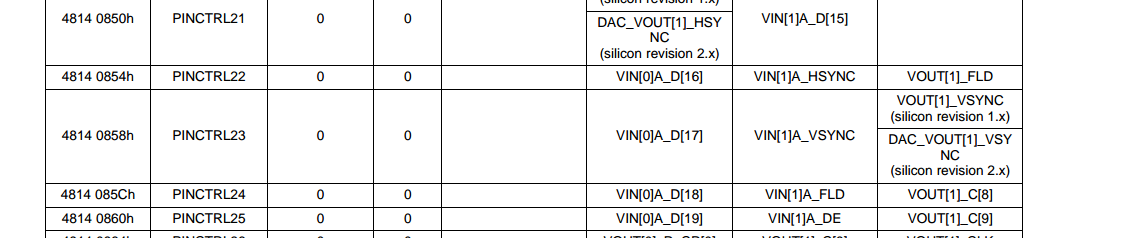

We are working on a custom board based on DM8168. We are using EZSDK(ti-ezsdk_dm816x-evm_5_05_02_00).
We have connected TVP5147 on VIP1 of DM8168 and configured it in 20bit 4:2:2 discrete sync mode. After enabling the decoder we are getting:
Dataclock = 13.5MHz
HSYNC = 15.625 KHz
VSYNC = 25
We have probed these things.
But when we are trying to capture video from the video port, the pipeline is getting stuck somewhere:
gst-launch omx_camera input-mode=16_BIT input-interface=VIP2_PORTA output-buffers=10 ! 'video/x-raw-yuv,width=720,height=288,framerate=60/1' ! gstperf ! omx_scaler ! omx_ctrl display-mode=OMX_DC_MODE_1080P_60 ! gstperf ! omx_videosink sync=false
Please guide me how else can i check whether data is being captured or not. Or whether there is some problem in pipeline itself?
We would like to use OMX only to capture the video.
