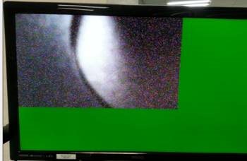

  • Hi manisha,
    Thanks for your reply.
    I have stopped both weston and matrix already before my test.
    This problem is strange, I did the same test on two different monitors (CHIMEI TL-42S400T, Sony KDL-42W700B),
    but results are different also.
    capturevpedisplay 1920 1080 yuyv 1920 1080 uyvy 0 1 -s 26:1920x1080
    Result:
    CHIMEI >>  Invalid argument problem, as mentioned before.
    Sony >> It works, but wrong display, as the figure shown below.
