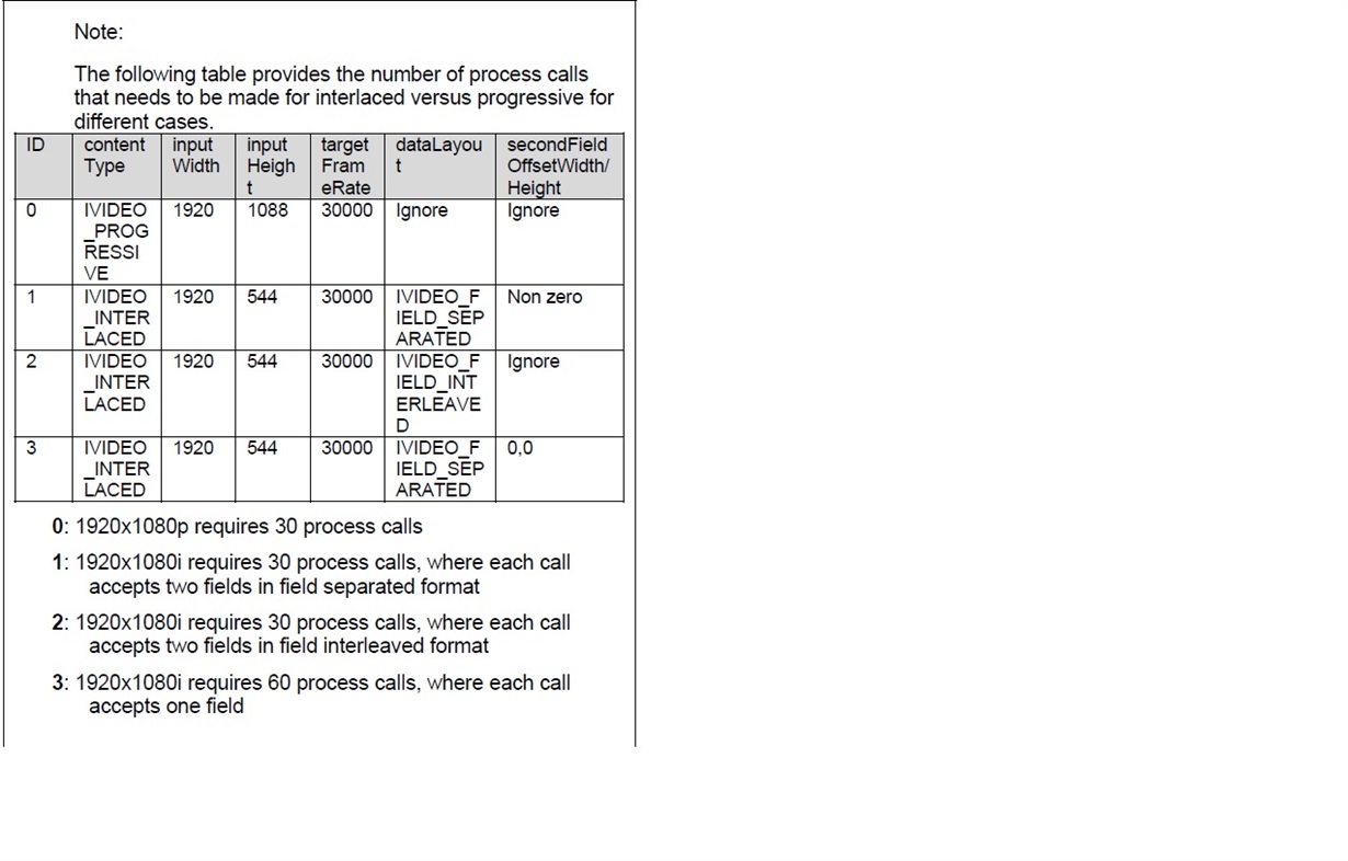

Currently we are using ezsdk_dm814x-evm_5_05_01_04 with NDA signed Overlay code. We are running demo for interlace encoding with Field seperated configuration.
We have following dataLayout configuration:
parameters.dataLayout = IVIDEO_FIELD_SEPARATED;
parameters.topFieldFirstFlag = 1;
parameters.secondFieldOffsetHeight[0] = 0;
parameters.secondFieldOffsetHeight[1] = 0;
parameters.secondFieldOffsetHeight[2] = 0;
parameters.secondFieldOffsetWidth[0] = 0;
parameters.secondFieldOffsetWidth[1] = 0;
parameters.secondFieldOffsetWidth[2] = 0;
Interlace Encoding is working correct but we observe following problem.
1. Last buffer given to encoder input is TOP field and then set "parameters.videoDynamicParams.h264EncDynamicParams.videnc2DynamicParams.forceFrame = IVIDEO_IDR_FRAME;" with setConfig. So once this setting done Encoder  start encode TOP field as bottom and Bottom as TOP field.
Please suggest change to resolve this problem as soon as possible.
