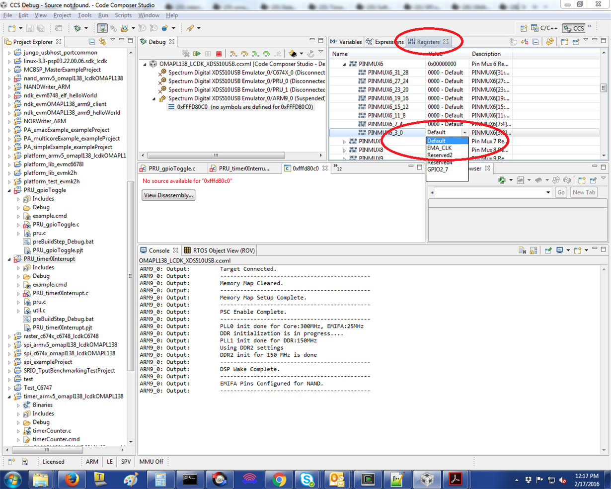

All:
I am trying to look at EMA_CLK with a logic analyzer, along with EMA_D[15:0], EMA_A[12:0], EMA_BA_1, EMA_BA0, EMA_WEn, EMA_OEn, and EMA_CSn_2.
I am running asynchronous mode, and I am able to sell all signals BUT EMA_CLK on a Logic Analyzer.
We have configured CE2CFG, and AWCC, and several pinmux's.
I have enabled pinmux6 for EMA_CLK, is there anything else I need to do to be able to see it? Does it need to be "enabled" to be output on GPIO2[7] on pin B7?
