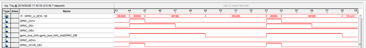

I have connected FPGA on GPMC interface using multiplexed IO mode. I have modifiled pin mux in u-boot as per attached mux_data.h file. Also I have done modification in gpmc_init function of u-boot as below:

After this much of modification I am trying to access FPGA registers, but I am not able to read any register. When I have probed GPMC signals I have found that there is no any transactions on signals. Even I can not see the clock also.
Here I have attached my fpga driver. Please note that I am using CS3 to access FPGA.
Could anyone please suggest me if I am missing anything?8171.mux_data.h

  • I will ask the software team to look at this. First thing I notice is that you are configuring the wrong registers. These listed on your post are used for NAND access only.
    Which SDK is this? Or which kernel version, if you are using non-ti kernel?
    Have you added gpmc pinmux configurations in dts? Also you need more settings than just changing gpmc status="okay", have a look at Documentation/devicetree/bindings/memory-controllers/omap-gpmc.txt

  • Hello Yordan,
    I am using SDK v2.0.0.
    I have tried to add pin muxing in dts file, but after adding pin mux, I was not able to boot the kernel, so I have kept it in u-boot only. After kernel boot, if I read registers, then register values are ok.
    Below are the pin mux settings I have tried to implement:
    I am trying to register char driver on GPMC. Below portion for GPMC is already available in dts file

    Please note that After kernel boot, the value of GPMC_SYSCONFIG reg is 0x11, which means GPMC is still in reset. I believe that once I change the status = "okay" then atlease GPMC should get enable.

    This is NOT enough.  When you connect a nor-like, nand-like, or ethernet or etc.. device, you need to add a child nodes in the DTS file. The code referenced from you is located in the DTSI file.
    So if your fpga is configured as nand-like device you need to add something like:

  • Hello Yordan,
    I am right now trying to read FPGA register. My configuration is 16-bit, nor like device, Synchronous read/write.
    I can see on fpga side that fpga revives proper address, and sends data out, but AM57xx does not read it. It gives always 0. So could you please let me know if I am missing anything?
    My timing configurations are as below:
            gpmc_t.sync_clk = 8001;
           gpmc_t.cs_on = 0;
           gpmc_t.cs_rd_off = 186*2;
           gpmc_t.cs_wr_off = 186*2;
           gpmc_t.we_on = 54*2;   //54
           gpmc_t.oe_on = 54*2;   //54
           gpmc_t.adv_on = 12*2;
           gpmc_t.adv_rd_off = 48*2;
           gpmc_t.adv_wr_off = 48*2;
           gpmc_t.we_off = 168*2;
           gpmc_t.oe_off = 168*2;
           gpmc_t.access = 114*2;
           gpmc_t.rd_cycle = 186*2;
           gpmc_t.wr_cycle = 186*2;
           gpmc_t.wr_access = 186*2;
           gpmc_t.wr_data_mux_bus = 90*2; //90
           gpmc_t.page_burst_access = 6*2;
           gpmc_t.bus_turnaround = 12*2;
           gpmc_t.cycle2cycle_delay = 18;
           gpmc_t.bool_timings.cycle2cyclesamecsen = 1;
    Also please see the attached timing diagram, I am trying to read register 0x0016.
