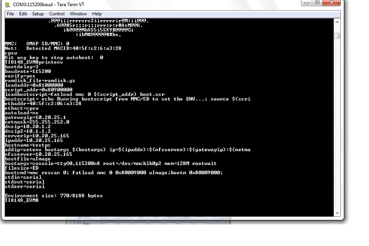

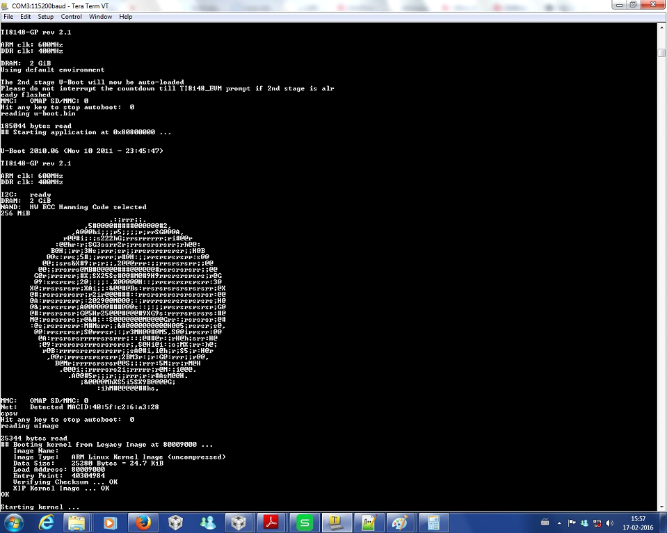

  • Hi Pavel,
    I am following step to create SD Card boot standalone.
    Step -1 Converted the CCS 4.2.4 built example  program to print on UART into bin file using CCS post build steps as follows
    "C:\ti\ccsv4\ccsv4\utils\tiobj2bin\tiobj2bin.bat" "boot_uart0_test.out" "boot_uart0_test.bin" "C:\ti\ccsv4\ccsv4\tools\compiler\tms470\bin\ofd470.exe" "C:\ti\ccsv4\ccsv4\tools\compiler\tms470\bin\hex470.exe" "C:\ti\ccsv4\ccsv4\utils\tiobj2bin\mkhex4bin.exe"
    2. converted the bin into ub image using following command  sudo mkimage -A arm -T kernel -C none -a 0x80009000 -e 0x40304984 –d /home/root1/APS/dinesh/boot_uart0_test/Debug/boot_uart0_test.bin  /home/root1/APS/dinesh/boot_uart0_test/Debug/boot_uart0_test.ub
    3. Created uImage by copying cp /home/root1/APS/dinesh/boot_uart0_test/Debug/boot_uart0_test.ub /home/root1/APS/dinesh/boot_uart0_test/Debug/uImage
    4. Copied above image to sd card boot partition manually.
    Then tried to boot from sd card by setting boot mode switches 11101. We get following output
    The Environment variables are as follows.
    Thanking you !!
    Dinesh
    From where you get these steps? I do not see such steps in the official u-boot/kernel documents:
    From the console log you have sent, it seems to me that u-boot is working/loading fine, the flow hang when should switch to the linux kernel. Are you

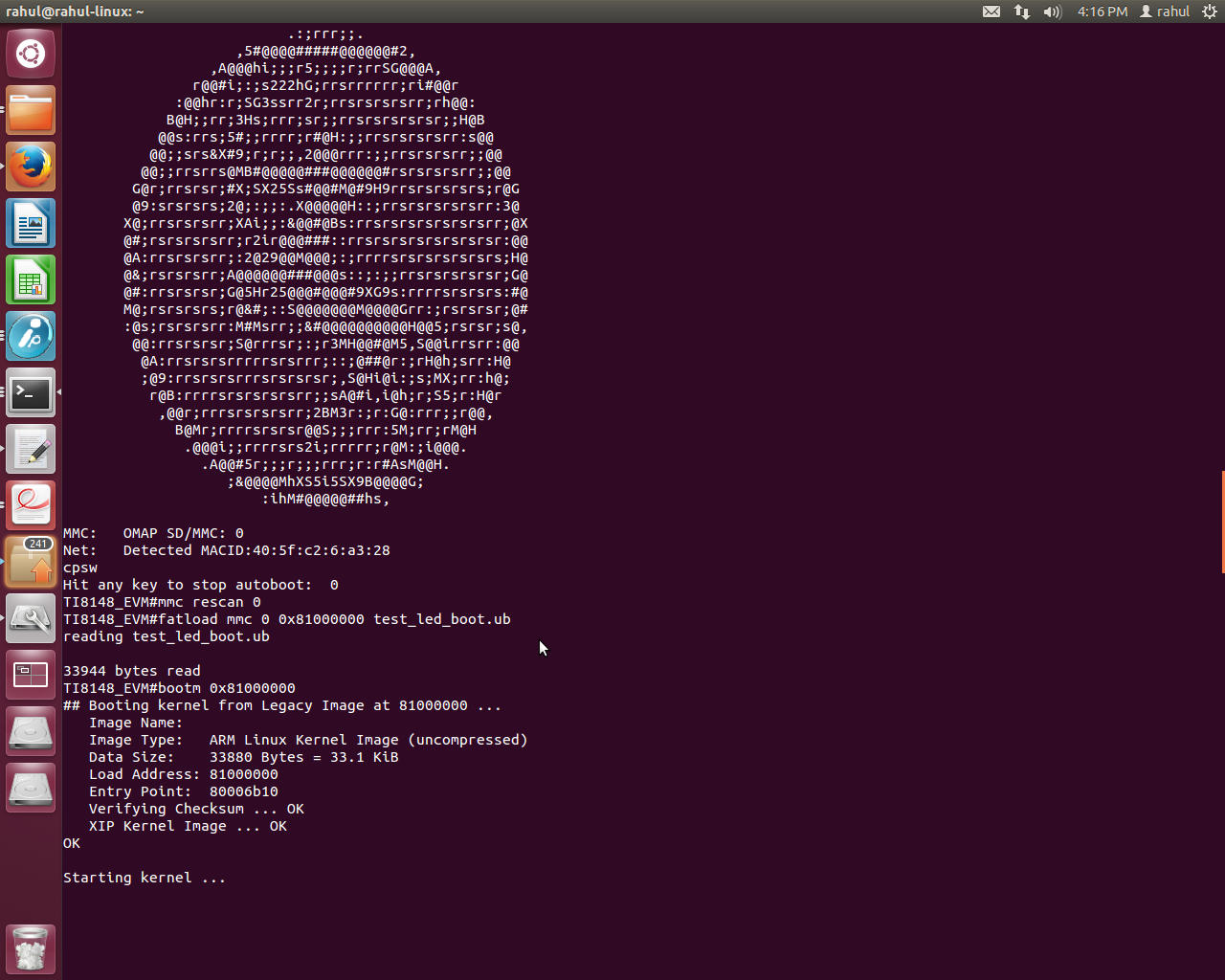

    5. We built the .out file using code composer studio 4.2.4 then converted it to uImage ( The .out file switches on LEDS on board. This was verified by using CCS ( GEL file was replace by c code) & same board.)
    ../TI/CodeSourcery/bin$ ./arm-none-linux-gnueabi-objcopy -I elf32-little -O binary /home/test_led_boot/test_led_boot.out  /home/test_led_boot/test_led_boot.bin
    sudo mkimage -A arm -T kernel  -C none -a 0x80000000 -e 0x80006b10 -d /home/test_led_boot/test_led_boot.bin     /home/test_led_boot/test_led_boot.ub
    cp /home/test_led_boot/test_led_boot.ub   /home/test_led_boot/uImage
    The image was copied on sd card & board was booted from SD card following is output.
    The wiki page you refer to explains how to run application which is created outside the CCS environment, application created in command line mode with makefile.
    Can you try that?
    The input file format should be elf32-little format (like mySysBiosApp.xa8fg). I suspect test_led_boot.out is not elf32-little format, can you check this?
    You are still using -a 0x80000000, can you comment on that point?? Did you really try with 0x81000000??
    I do not see such command in the wiki, to rename test_led_boot.ub with uImage, can you comment on that point? What makes you think you have to rename this
    out file to linux kernel image??
    Pavel
