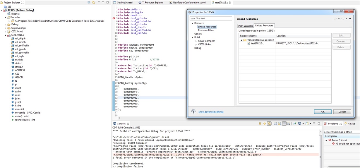

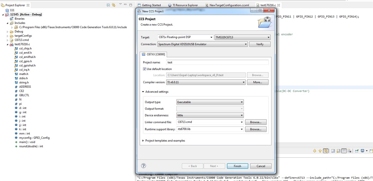

I am new in CCS6.0. Previously i was working on CCSv3.1 and CCSv3.3. I have developed one project on CCSv3.1 and now i want run it on ccsv6.0 and load into DSP hardware c6713. I have create new project in ccsv6.0 and import the .c file which was developed and tested successfully. But after the file import, some error are shown. Related error are GPIO function (Error: could not open source file "csl_gpio.h").
But I have followed all the instruction for create a new project  and included c6000-tool-6.0.11 library for TMS320c6713 . How to sure that all functions used in ccsv3.1 will work correctly on CCSv6.0.

    Thanks for your kind response. I have followed your instruction and added linked path. After that the same problem has been raised again.
    Could not open any .h header file  and  any function of GPIO library or any other function like  DSK6713_waitusec(227 * 500) is shown compilation error.
    Again i have sent you two sample snaps of my testing project that will help you for idea about my project link file setting and project compilation error.
    and also send you one new project setup snap. Hope that these will help to understand where are my exact problem.
    wait for your reply.
    Please find the attachment

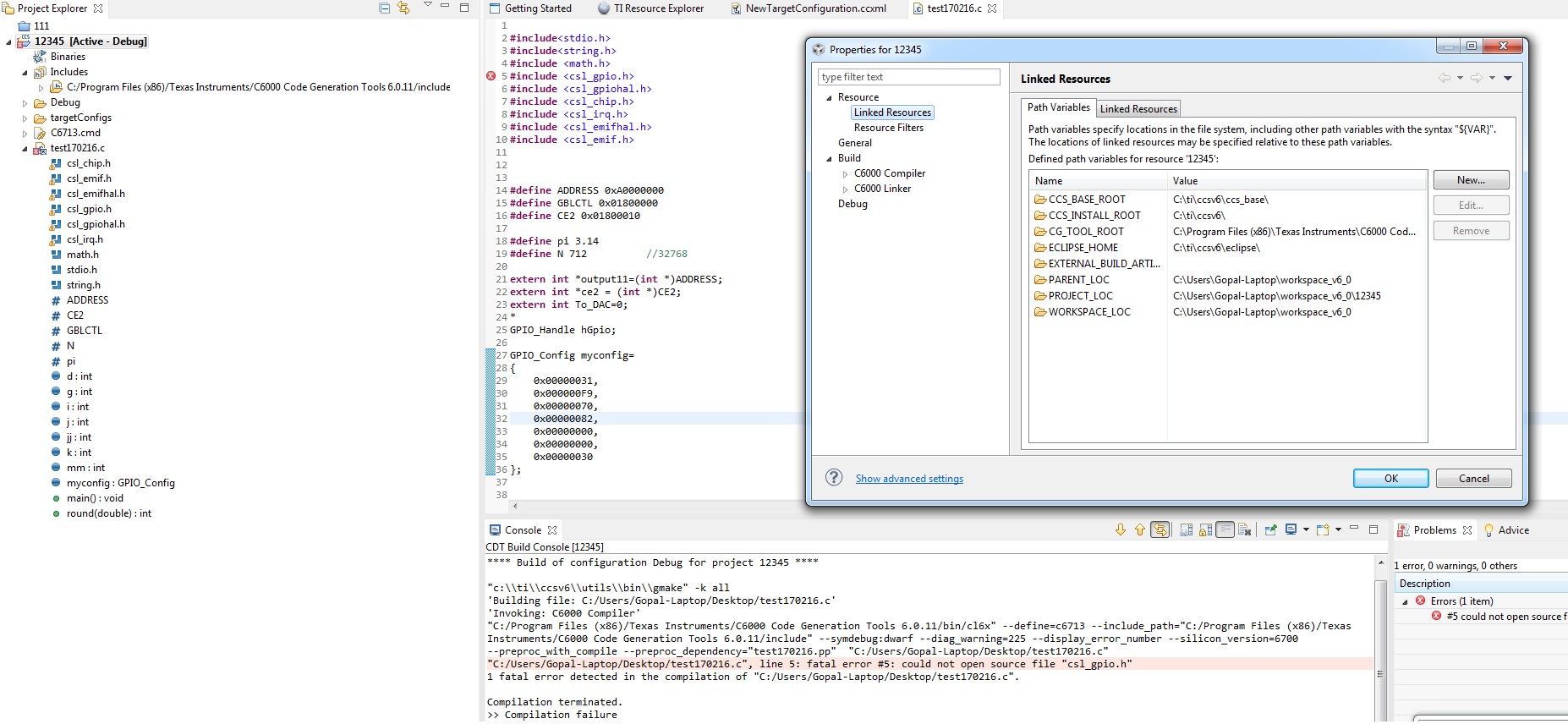

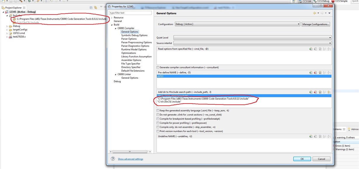

  • Hi Gopal,
    Actually I'm mentioning the different "include option" in CCS properties settings.
    CCS Properties -> Build -> C6000 Compiler -> Include option ->
    Add the following line in "--include_path" section.
    C:\ti\C6xCSL\include

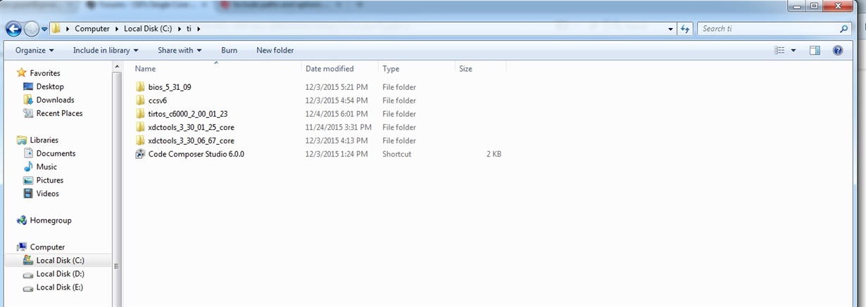

  • Hi Shankari
    I have  checked this path and added "C:\ti\C6xCSL\include".  I have tested with same error. But practically i have seen that inside c://ti/ directory, have no any this type of directory(C6xCSL).  I have search my install compiler directory and added this path(C:\Program Files (x86)\Texas Instruments\C6000 Code Generation Tools 6.0.11\include) in that path and compiled again. But error is not short out. same problem is raised.
    Please see the sample snaps.

  • Hi Shankari
    My compiler installation location is C:\Program Files (x86)\Texas Instruments\C6000 Code Generation Tools 6.0.11\include. and added it in that position as per your instruction. For my eval kit tms320c6713, i have searched and installed "C6000 Code Generation Tools 6.0.11" tool separately, which snap , i have sent to you my last reply. But after build/compilation, same problem is raised(Error: could not open source file "csl_gpio.h"). I have tried & checked in different way and seen that no any .h file is not open like csl_chip.h, csl_emifhal.h, csl_emif.h etc. is not opened. show same error.

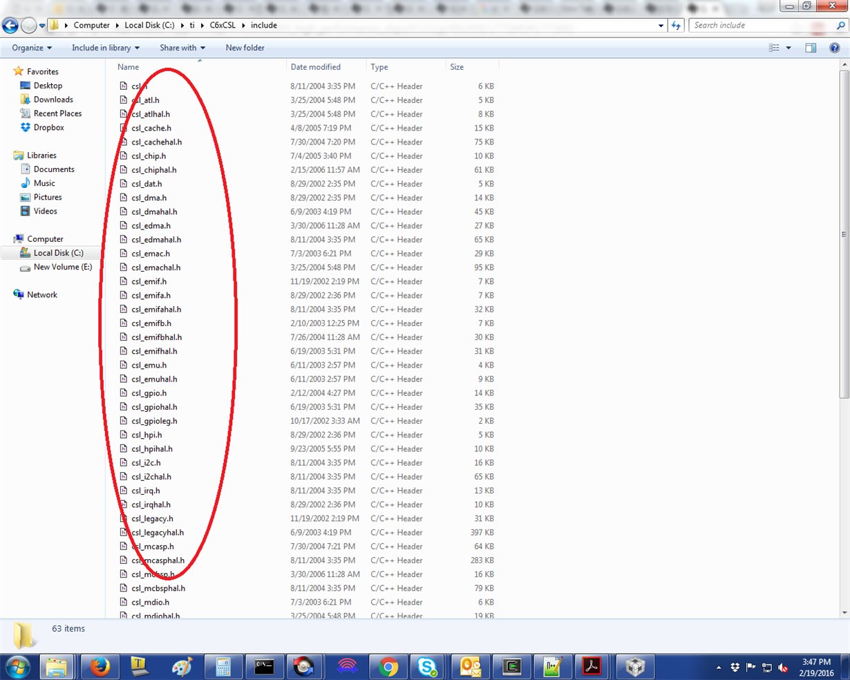

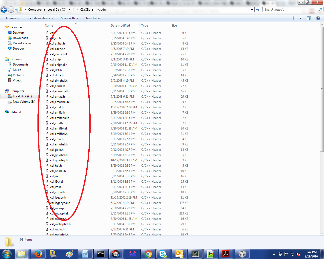

  • Hi Gopal,
    Able to see the include files like this in your PC ?
    You can get this include from the following link.
  • Hi Shankari

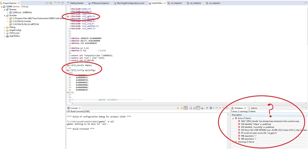

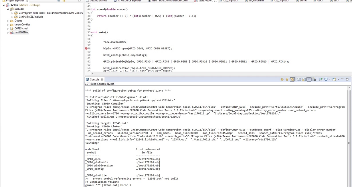

    Hope that i have progress about my troubleshoot process. I have installed again TMS320C6000 chip support library in c://ti path and added it as per your previous instruction. Rebuild again, and that previous error not come at this time. But show another error regarding Chip select ("C:/ti/C6xCSL/include/csl_chiphal.h", line 267: fatal error #35: #error NO CHIP DEFINED (use -dCHIP_XXXX where XXXX is chip number, i.e. 6201). I defined in ccsv3.1 tool in build option->preprocessor path with CHIP_6713. But for ccsv6.0, i have not found the exact path where i can define my chip name. Is this same chip name(CHIP_6713) for ccsv6.0 or any other? if possible kindly tell me the option where i can define my chip name.
  • HI Shankari
    Hope that my last reply, you have read and kindly see my next line for my last observation.

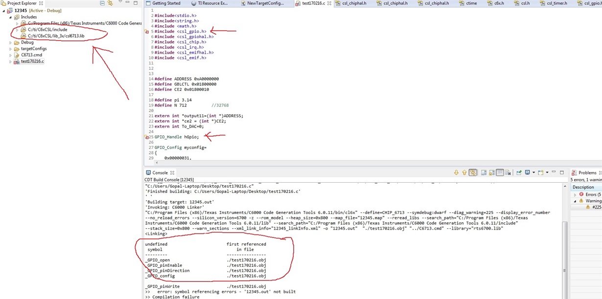

    I have tried & defined the CHIP number(CHIP_6713) in this path Project property->general option->Pre define name option. After rebuild, this CHIP define error is not shown, but some error has come regarding "Undefied symbol " (Please find the attachment snap for details)
  • Include any one of this library in your CCS project settings.
    CCS Properties -> Build -> C6000 Linker -> File search path
    C:\ti\C6xCSL\lib_3x\csl6713e.lib
    Or
    C:\ti\C6xCSL\lib_3x\csl6713.lib
  •  Hi Shankari
    Sorry for my late response. Last two days was our office weekend days. so i can't reply at that time.
    I have followed your last instruction and add this  C:\ti\C6xCSL\lib_3x\csl6713.lib in a same way and recompile it, but same error has come.
    kindly find the attachment for my last compilation.

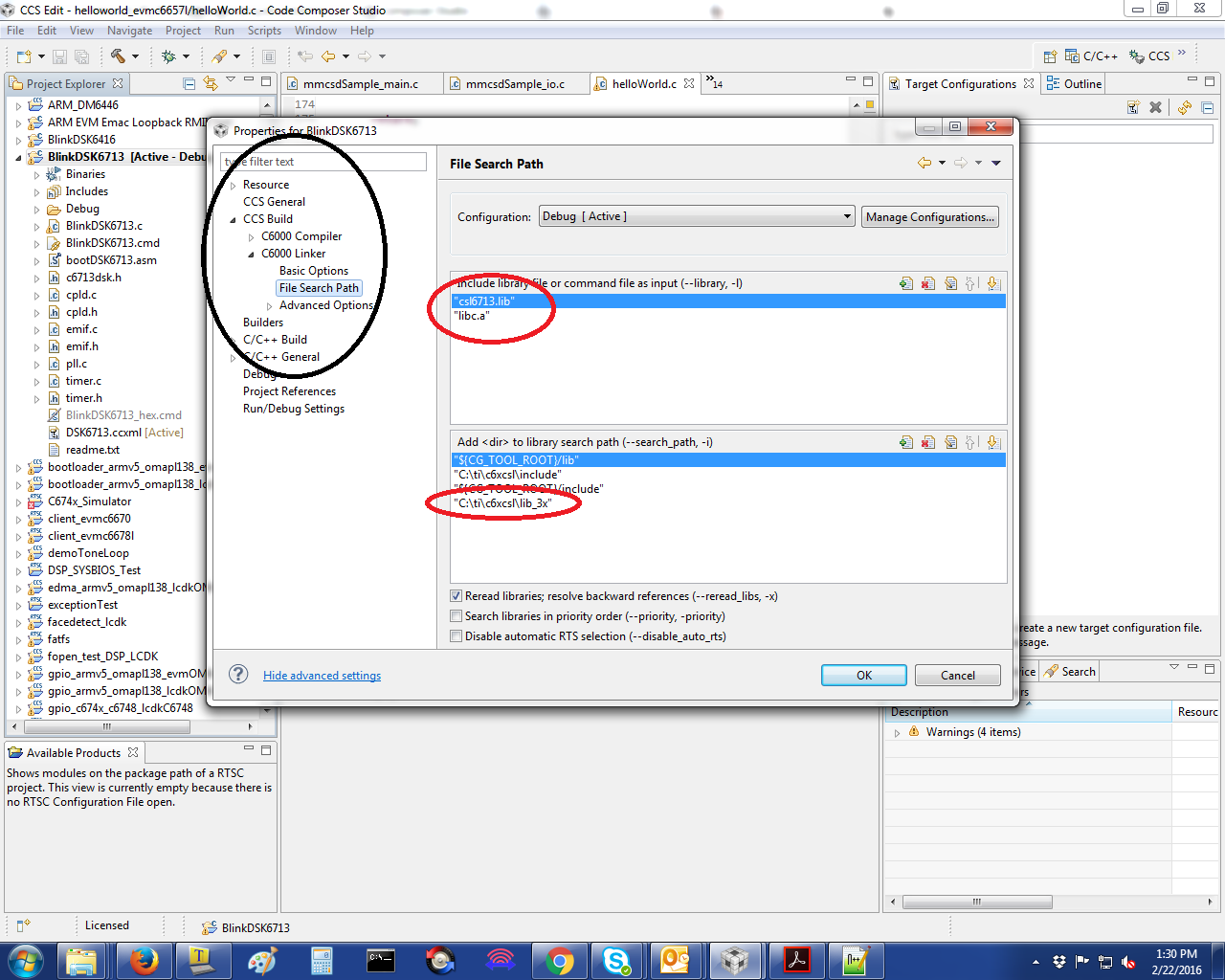

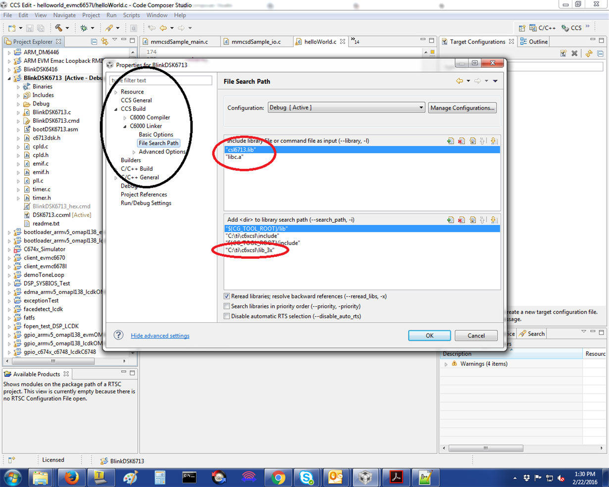

  • Hi Gopal,
    Did you refer this post?
    I was clearly mentioned that you have to include the library in given location but you have added in some where (where we include headers)
    Check the attachment.
    Please create a new post if you have further questions on this.

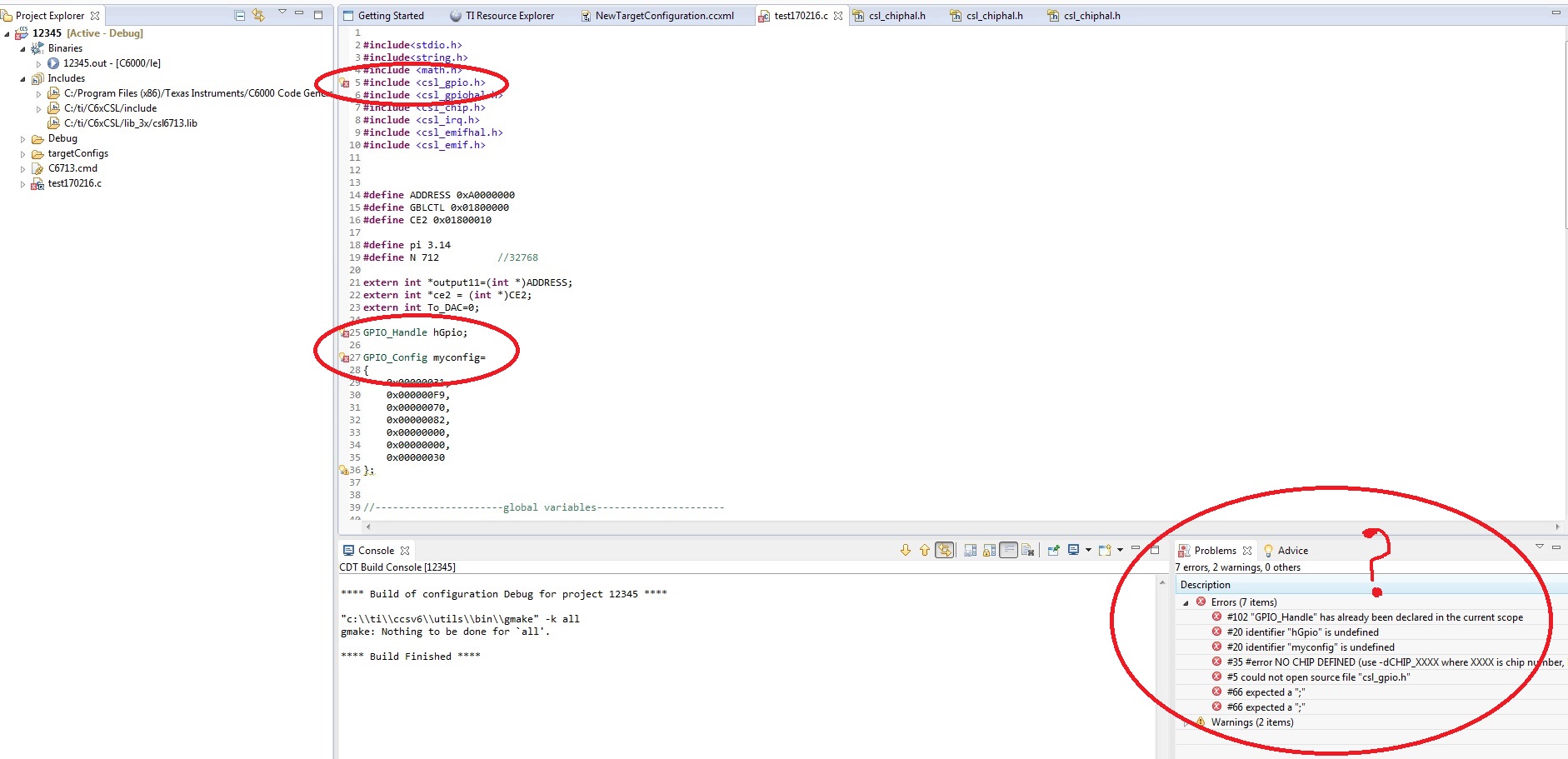

  • Thanks Shankari for your guide and kind instruction.
    After followed your last instruction, there have no any compilation error messages. But i have felt some another small issues.
    I have seen that there have some error "mark" regarding GPIO declaration & config. These are not omit after build and also show one
    No CHIP Define error. kindly see the attachment please. How to over come these issues?
