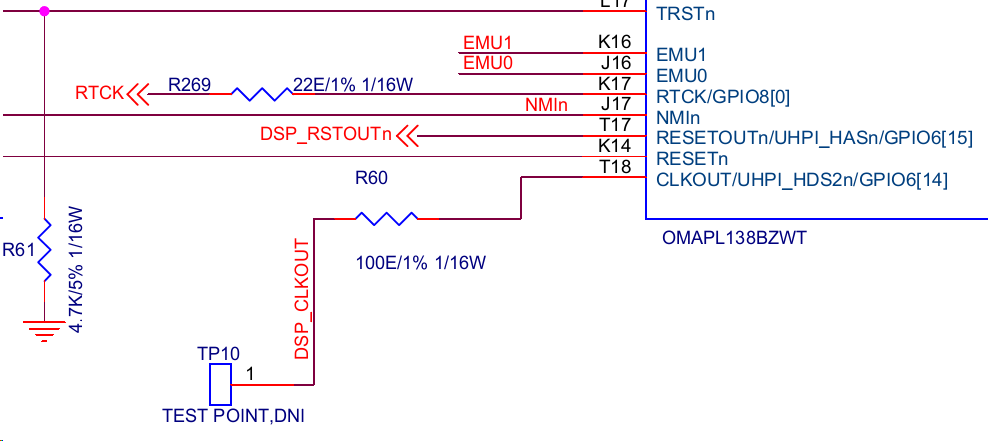

I flashed my DSP project into the FLASH memory with the StarterWare bootloader. My project uses UART port which sends data when I push a button on the board. The speed of the UART port is 115200 and when I start my application in debug mode everything seems fine. But if I measure the UART speed when my application starts from the FLASH memory the speed doesn't match the expected value: I've got about 75500 instead.
It seems like the clock frequency of DSP became slower. My DSP project works with SYSBIOS and I thought BIOS configures clock frequency itself.
What is the problem?

    Can you please measure the OMAP frequency via CLKOUT pin ?
  •  Do you mean that pin?
    I haven't got anything at TEST POINT 10 - just a constant level.
  • Yes. I meant that pin only.
    It seems to be you haven't enabled the PINMUX for that pin. (PINMUX13_7_4)
    Already I've done this and able to probe the all the SYSCLK via this CLKOUT pin.
  • Ok, it just show me 24 MHz clock frequency.
    And this absolutely doesn't solve my problem - my project configured for 300 MHz, but I got less.
    Then, I think, its not showing the DSP or OMAP frequency but OSCIN frequency i.e 24MHz.
    OCSEL.OCSRC bit has default value "0x14"
    If you want to probe the particular SYSCLKs then you have to change the PLL0 OCSEL register.
    Ex, if you want to probe the PLL0_SYSCLK1 (DSP frequency) then you have to write "0x17" into OCSEL.OCSRC bits.
    Please refer to the OMAPL138 TRM , page no 159, chapter 8.3.7.
    Let me know if any.
  • Ok, I've just realized that I need to observe PLL0_SYSCLK1.
    This frequency is 300 MHz.
    Is it anything wrong with peripheral clocks?
  • Situation is more interesting than I thought. My UART0 get clocks from PLL0 with fixed division ratio 2 (PLL0_SYSCLK2). So I have DSP frequency / 2 as a clock source. My UART speed settings were incorrect for 300 MHz speed. So my DSP with u-boot was clocked before at frequency more than 300 MHz! And when I get the right frequency speed became less than I expected. So I corrected divisor in UART0 to another value.
