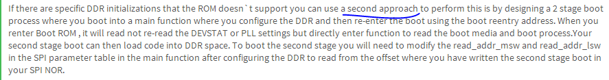

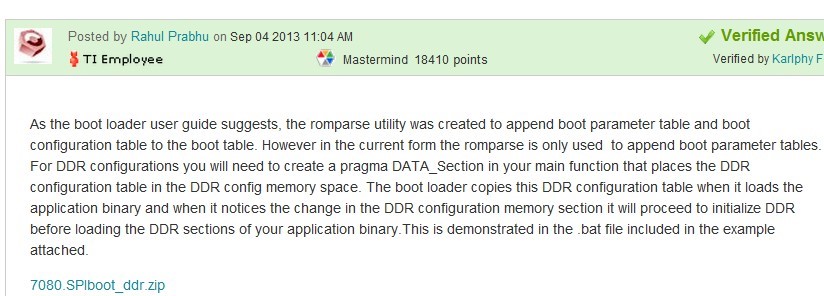

    2.By the meantime ,I have another question need your help. About DDR boot configure on 6638.
    Look, for 6638 DDR configuration during boot, is it the same  with 6670?? If so, a ddr configuration example would be highly appreciated!
    3. I have studied the documents about DSP bootloader. The boot loader user guide tells we should use boot configure table to config the DDR,and show the detail boot config table format  again and again. BUT, we just use a DATA_SECTION to config the ddr. There is NOTHING to do with boot configuration table so far!
    So, can you please tell me,if I want to use the boot configuration table (a series of Entry Addr,Set mask,Clear mask...). How to use, how to append the boot configuration table to my boot image(.bin file).If I can config the Register use boot configuration table, I can confiure all the DDR registers,and no need to have a second stage to configure the specifies registers.Like you demonstrate below.

  • Hi Frank,
    I have quickly put together an DSP SPI boot example for you to try on the K2HK device. This example doesn`t configure the DDR but will demonstrate how to create the boot image and how to use romparse. I have not tested this on an EVM but this example has been tested on our custom hardware used to bring up new silicon. You can modify the boot parameter table as per your application requirements.
    Boot_K2H_SPI.zip
    TO rebuild the example, set the ARM and DSP compiler path in the .sh or .bat file and run make all in spiboot_test folder. The folder contains all the utilities required to build a SPI boot image in boot table format.
    To answer you second set of questions. The DDR configuration table for K2H, is described in section 8.1.2.4.10 K2H data sheet here:
    The structure for DDR configuration table is also defined in the tiboot.h file that we have provided in the Keystone II boot examples

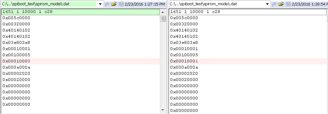

    Q1.  In spirom.map file, I changed value  " mode = 0" to "mode =1", the result .ccs file after romparsed is still 00 00; it doesn't make sense,can you have a try?

  • Hi Frank,
    Thanks for reviewing the utility and the output of the utility.  Here are my response to your questions.
    I tried this at my end and I do see the mode value change. Here is the snapshot from the diff:
