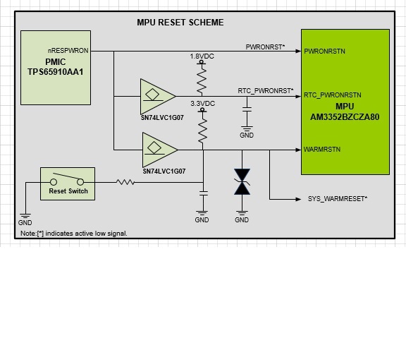

AM3352 Query regarding RTC time functionality feature
Other Parts Discussed in Thread: AM3352
We are using "RTC timer functionality but no RTC-only mode" . As per page no 6 of AM335x Schematic Checklist it is written that "any AM335x 1.8 V power supply3"  to be used for VDDS_RTC connection. We understand that "any AM335x 1.8 V power supply3" means that we can use external LDO for supply 1.8V power supply to VDDS_RTC connection.
We  assume that "any AM335x 1.8 V power supply3" doesn't mean that we need to use 1.8V power supply which is being driven by AM335X 1.8V supply rail.
Please confirm our understanding.
