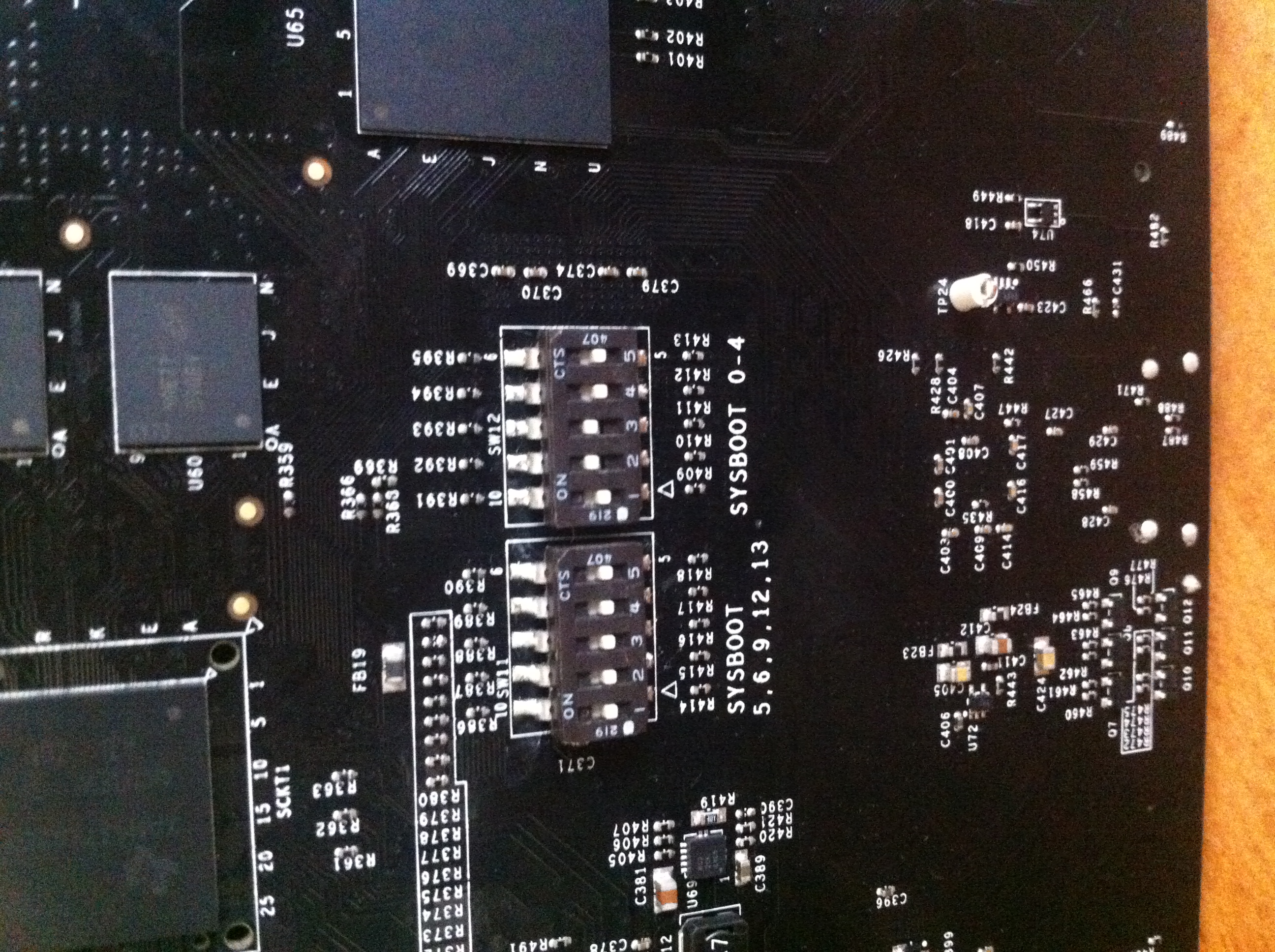

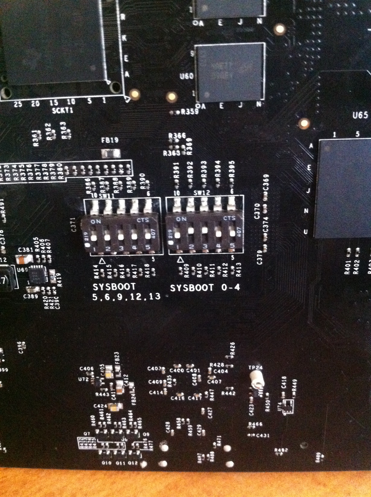

  • In this situation, you probably need to setup the SYSBOOT switch to boot from NAND device. Check this: processors.wiki.ti.com/.../AM437x_General_Purpose_EVM_HW_User_Guide
  • Hi Kemal,
    after refering the datasheet i understand the sys boot [0-4] should be [01111b] from the datasheet spruhl7d page 189.
    even after enabling the switch 12 in my GPEVM to those corresponding values. it fails to boot from the nand flash without the sd card inserted into the sd card slot. what could i be doing wrong here??
    after setting these switch to the respective settings the board does not boot. or in other words the uart in minicom is not responsive.
    regards
    -Ash
  • Could you try this sysboot [0-4] [01100b]
  • Hi Kemal,
    The board still does not boot using the sysboot [01100b]. Can i be misssing something here ??
    My board revision is 1.4a is this a contributing factor ??
    -Ash

    Could you also take a picture of the EVM's sysboot switch and attach?
  • Hi Kemal,
    Please find the attachments for the switches

    above is my switch setting (fyi i have tried the exact inverse of the switches as well as on and off state is confusing)
    -Ash
  • Yes they should be in inverse position. The state is off if the switch is closer to pinouts 6-10.
  • In The inverse position i do not even get the ccccc in my terminal.
    -Ash
  • The EVM sends the CCCCC in UART boot mode.
  • But after inversing the swithes. the uart output is nil and the board does not boot. i had to set all the switches to off so that i can boot the board again.
    regards
    ash
  • Could you try with all 0, by default the EVM should first try to boot from NAND.
