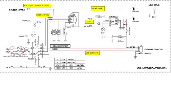

I have a big problem, I use Dm355 as a camera with wifi function. so I select an usb wifi module(ralink RT3070 chip). this usb wifi is working very nice on DM355. but my camera is also connected with PC by USB cable,
Because this usb wifi must be in the body,and DM355 has only one USB controller, so I have to use a high speed usb switch to switch usb D+,D- .
when the camera is working at usb cable mode(connected with PC), usb wifi is powered off,  a fig can show this.
1: DM355 as a slave device, PC as a host, everything is good, whatever which usb switch is used.
2:if DM355 as a host, it cann't communicte with usb wifi module(usb switch is on the bus)
3:but if usb switch is removed, Dm355 can communicate with usb wifi module,
This usb switch is also TI product, TS3USB30E.
It seems that the Ron resistance of usb switch disturb the usb line, and the DM355 cannot drive the usb wifi module.
Can any body give me some advice?
Thanks!
  • David,
    In your configuration I assume the product will either work with PC (as a device) or with Wifi (as host) over USB at a given time.
    In the above layout I see that the ID pin from the connector is not connected to the ID pin of the DM355 usb controller (ID pin at device connector is going to TV out, ID pin at host connector is getting grounded).  Without the ID pin sense DM355 usb controller will not swith modes and probably explains the problem you are experiencing.
    Having said that you would also need to set the DM355 usb driver in the correct mode when you are switching the D+/D- pins.  For this you would need to build the USB driver in OTG mode.  This will enable the USB controller to sense the ID pin and accordingly the USB driver can switch mode dynamically.
    In summary there are 2 issues as below
    • ID pin not connected to the DM355 USB controller
    • USB driver not built in OTG mode.
    regards
    swami
  • thanks a lot!
    you are right!
    USB controller is not OTG mode in my product. in fact,  I have a extra pin to judge the power mode,  if powered by usb cable (connected with pc), ID pin is pulled up, and Dm355 as a device.
    usb over network driver  file is inserted. if powered by battery, ID pin is pulled down, and usb wifi KO driver is inserted. then DM355 is a host.
  • David,
    I believe you should be able to achieve your end goal without radically changing your configuration.  When you are loading your related .ko's can you also build the USB driver as module and reload it too?
    Meaning build the usb controller as a kernel module (musb_hdrc.ko) and everytime you are switching the roles unload the existing musb_hdrc.ko module and reload the new musb_hdrc.ko module (that has been built to support the new mode).
    If the above is not possible then the only option left is to built the usb driver in OTG mode.
    regards
    swami
