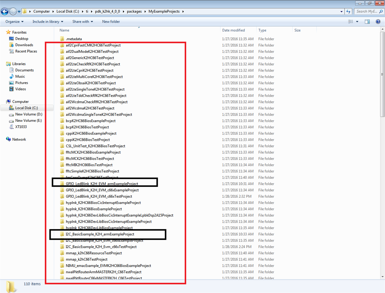

  • Hi Douglas,
    After installing the "processor_sdk_rtos_k2hk_2_00_01_06", you will observe that the package, "pdk_k2hk_4_0_0" got installed.
    Steps:
    1. Navigate to pdk_[soc]_[version]\packages
    2. Run pdksetupenv.bat  -- To set up the environmental variables.
    3. pdkProjectCreate.bat - To create the pdk test projects.
    Run pdksetupenv.bat like below
    >cd C:\ti\pdk_k2hk_4_0_0\packages
    C:\ti\pdk_k2hk_4_0_0\packages> pdksetupenv.bat
    pdkProjectCreate.bat [soc] [board] [endian] [module] [processor] [pdkDir]
    Run pdkProjectCreate.bat like below.
    C:\ti\pdk_k2hk_4_0_0\packages>pdkProjectCreate.bat K2H all little all arm
    Please refer to
    This will generate PDK examples in the folder like below:
    Once the PDK test projects are generated, you will find the CCS project files for each project. You can import into CCS and use it.

    You can choose "Generic A15" option.
