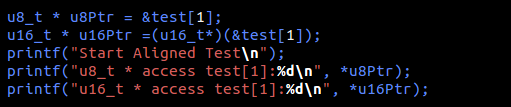

I tested unaligned  access  with the code above in u-boot, when I ran the code, I got
Start Aligned Test
u8_t * access test[1]:0 #CPU halt here
CCCCCCCC
test is  defined as global array  u8_t test[1000] = {0};
I am using SDK ti-processor-sdk-lnux-am335x-evm-01.00.00.03
and I try to add -munaligned-access -fno-conserve-stack  to KBUILD_CFAGS in the root Makefile of uboot, but it seems not work.
I also update the u-boot/arch/arm/cpu/armv7/config.mk -mno-unaligned-accss to -munaligned-access, it seems not work neither.
What's the problem?

    you have to align your buffer correctly to access it correctly depending on your pointer.
    for example when using GCC, use "__attribute__((aligned(xxx)));" when defining your buffer with xxx the correct alignment/misalignment value. Refer to your compiler documentation for "alignment" attribute.

    This may be not an option: if you access to a variable which is not correctly aligned vs the type you are accessing, unless these is handled by the gcc with correct option (--no_unaligned_access), your CPU crashes (it is on my side with the compiler option I set)
    In your example, "test" is an array of bytes; you can access to any bytes with a pointer to byte with no problem.
    Considering that your array is aligned on a 16-bit word, accessing to test[0] will work but accessing to test[1] with a 16-bit pointer may crashes your cpu when this is not handled by the compiler.
    refer to infocenter.arm.com/.../index.jsp if not already done ^^
    "The --no_unaligned_access flag tells the compiler not to knowingly generate unaligned accesses. What is the significance of knowingly? [...] As mentioned above, a pointer should contain an address with correct alignment for the type.[...] The compiler will generate code on the assumption that a pointer is correctly aligned. It does not add code to perform run-time checks."
    and arch/arm/cpu/armv7/config.mk makefile in your U-boot
    Implementing a sw and ignoring data alignment will decrease performance. I suggest you to align buffers or put your code elsewhere from U-boot to set your own compiler option.
    Good luck!

    You are right exactly. I have uip ran in arm926ejs which is armv5l, it works.
    i found -munaligned-access -mno-unaligned-access in arm gcc may not works for me except the code is aligned 4 bytes and i access it as 4 bytes aligned? Not sure.
    gcc.gnu.org/.../ARM-Options.html
