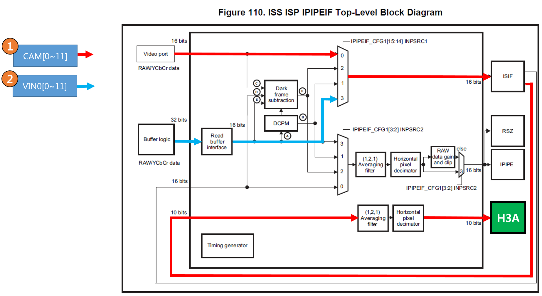

I want to use the dual sensor (IMX322 + IMX322) on DM385 for BlackBox application.
The data by the camera interface passes through the ISIF. H3A data is available in this case.
But the data by the video interface passes through the HDVPSS instead of the ISIF.
So I can't get H3A data for this interface.
Is it possible to get H3A data for the video interface like the camera interface?
