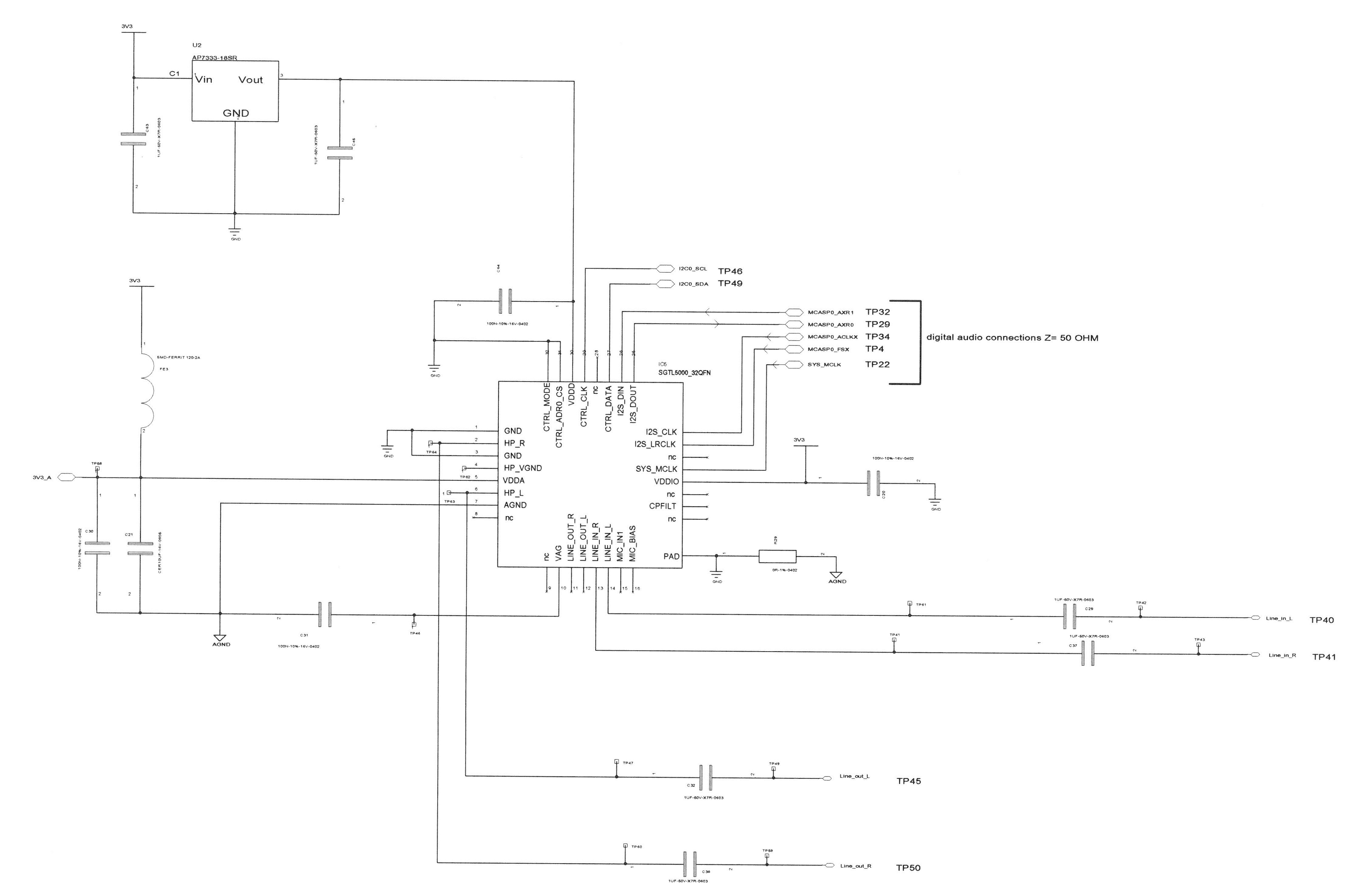

I'm facing a problem with the integration of a sgtl5000 codec on our custom AM335x hardware. We're using linux kernel 3.12.10.
Playing a wave file or speaker-test is possible and works as expected. What goes wrong is the recording of the line in signal. Calling "arecord -f cd test.wav" produces an empty file although I have set the controls for recording via alsamixer (capture volume = max, capture source=LINE_IN). Unfortunatelly no error messages were displayed.
Any help would be appreciated.

Here is the output from dmesg:
# dmesg | grep -i sgtl
[    1.815346] sgtl5000 0-000a: sgtl5000 revision 0x11
[    1.912585] sgtl5000 0-000a: Using internal LDO instead of VDDD
[    1.928645] davinci_evm sound.3:  sgtl5000 <-> 48038000.mcasp mapping ok
This is how we connected the codec:

  • Hi Biser, Hi Yordan,
    Thanks for your replies. It happened with all formats. But now I've found the problem. We'll need stereo capturing for our project, so I have always captured the line in signal on the left line in channel and measured the left output channel. Yesterday I have take a closer look at the *.wav-file and it was correct recorded. The problem is that the aplay command seems to swap the output channels so that the output sine signal is on the right channel. I guess this could be caused by the wrong frame clock. Maybe it needs to be inverted. Today I will try to change SND_SOC_DAIFMT_IB_NF to SND_SOC_DAIFMT_IB_IF or SND_SOC_DAIFMT_NB_IF.
    I will let you know, if this fixes the issue.
    Sascha
    I've played around with the dai_fmt-flags. Unfortunatelly I was not able to fix the swapped line out channels.
    During the evaluation of the codec in a SIP client application, we've found out that there is another problem where I don't have any ideas on how to fix it. When we are playing the recorded line in signal on the line out in "real time" (arecord | aplay) there are hearable cracking sounds present. We haven't seen this issue if we are recording and playing a wav file sequentially.
    Maybe someone can help me.
