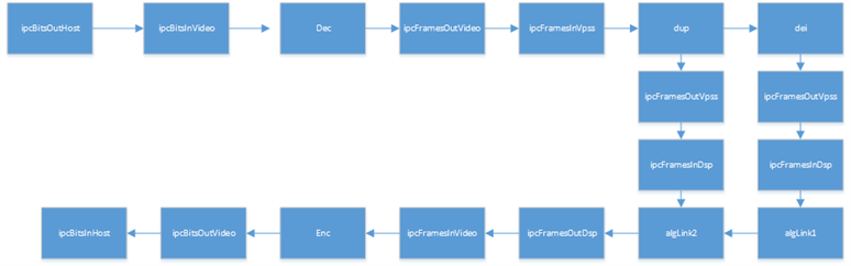

  • Hi
     REL.500.V.H264AVC.D.HP.IVAHD.02.00.08.00    REL.500.V.H264AVC.E.IVAHD.02.00.06.00
     My application link flow :   because the decoder output have padding pixels, it cause all following link process frame with padding pixels.
  • Hi Eric,
    In that case only you have to handle the inputBufDesc of  imageRegion & activeFrameRegion.
    imageRegion  ==> Whole frame as image region ( e.g 2048x2048)
    ActiveFrameRegion ==> Only contents need to be used for encoding ( e.g 1920x1080).
    So the ActiveFrameRegion can be anywhere in ImageRegion. So in the RDK Framework, please check the below parameters for the region selection.
    For Image Region = Pad + Input Width = Also called Capture Width
    For Active Region = Only input Width
    Similar modification for Height.
