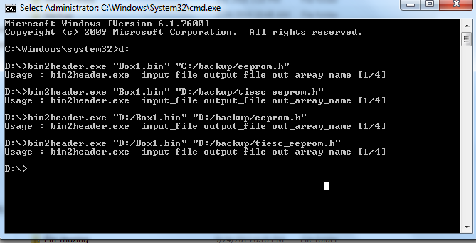

We are trying to use the bin2header.exe to generate EEPROM header file for etherCAT.
But it is not generating file.
Can you please help us on this?
SDK used - sysbios_ind_sdk_2.1.0.1

As the message shows, the exe requires one more param as input "out_array_name". This will be the name of the array generated in the header file. It seems this is not updated in the User guide, will get this updated.

Thanks Vinesh,
bin2header.exe "Box1.bin" "d:/eeprom.h" tiesc_eeprom
the above commands works properly :)
