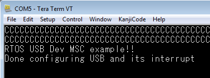

  • Outstanding, Eric!
    It's running as I type this, and as they say:  a picture is worth a thousand words:
    The call to  USB_open()  (which wasn't returning)  comes just before the "Done configuring USB and its interrupt" string is printed, and  USB_open()  call is certainly now returning, and
    ...clearly it is working.

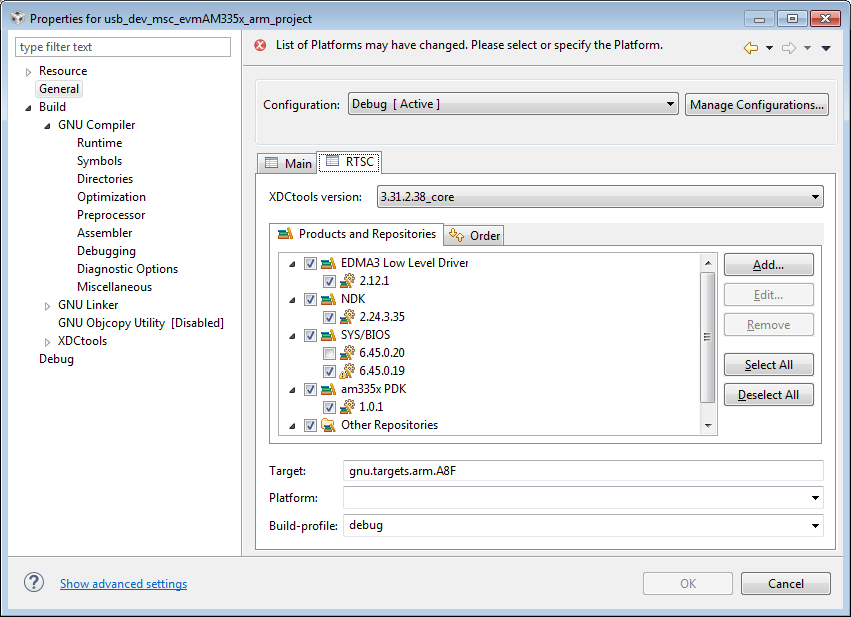

    5.  I imported it and opened Project > Properties to observe an error I encountered previously (see device):

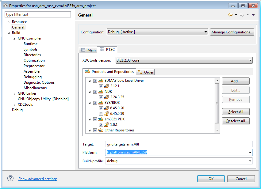

    6.  I corrected that to EVMAM3358 and also correctly set the connection.
    7.  On the RTSC tab I observe that SYS/BIOS 6.45.0.19 compains of having no repositories (and the Platform drop-down list has a VERY incomplete list)...
    8.  ...so I switch it to 6.45.0.20 (and now the Platform has "the normal" -- at least from what I've seen so far -- list).

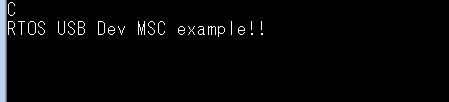

    10.  I click the green "debug" tool-bar button, and it fails in the same way:  call never returns from  USB_open() and I get this on the serial output:

    I power cycled my EVM and loaded your .out file, it always stuck at USB_open(). So it is not the test setup issue, but build steps issue. Attached is my package.

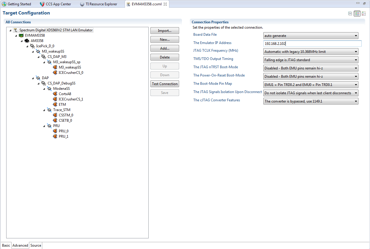

    Now the import sequence looks like this (I have an XDS560V2 STM LAN emulator):
    ...and the RTSC tab...
    ...is already correct without any changes needing to be made.  To connect to the LAN emulator, it needs to know the emulator's IP address, so I set that by opening the  .ccxml   file here:
    ...and replacing   "x.x.x.x"   with the emulator's IP address:
    ...and I do a BUILD on the project.  It compiles and links correctly the first time.  And I click the green "debug" button (to load the program and debug it), and the whole thing works right the first time:  it enumerates with the PC, PC formats the mass storage device, and everything works.
