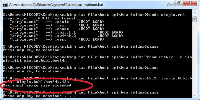

I want boot client project via SPI on 6678 evaluation board.
At first I want making bin file from "client.out". So I rename "client.out" to "simple.out" and use "spiboot.bat" as following text:
spiboot.bat:
hex6x simple.rmd
pause
bconvert64x -le simple.btbl simple.btbl.bcv64x
pause
b2i2c simple.btbl.bcv64x simple.btbl.bcv64x.i2c
pause
b2ccs simple.btbl.bcv64x.i2c simple.btbl.bcv64x.i2c.ccs
pause
romparse my_boot.map
pause
ccs2bin -swap i2crom.ccs spirom_le.swap.bin
pause

My first question is :
When I run "b2i2c simple.btbl.bcv64x simple.btbl.bcv64x.i2c", I face with the following error

    Thanks for your reply. I used that client project in mcsdk\example directory but I changed that for ignoring DDR and used MSMCSRAM memory instead so I don't need Initialize DDR for boot.
  • Hi
    Can everybody help me to fix my problem? I can't make bin file from "client.out" yet. I changed client project and don't use DDR in my project but when I use "b2i2c.exe" in directory "mcsdk_2_01_02_06\tools\boot_loader\ibl\src\util\btoccs" i face with this error:"Max input array size exceed"
    Should I change "b2i2c.c" for ignoring this error? If yes, What change I must do?
