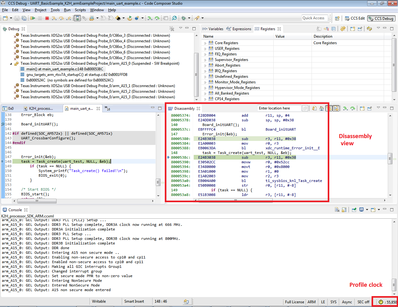

  • Hi Tom,
    Able to enable the profile clock feature in CCS 6.1.2 .
    Steps to enable profile clock:
    1. Load the program ,run it on target.
    2. Run --> Clock --> Enable --- You will observe the profile clock at the right corner of the window like below.
    3. To view the Disassembly --->CCS --> View Disassembly.
