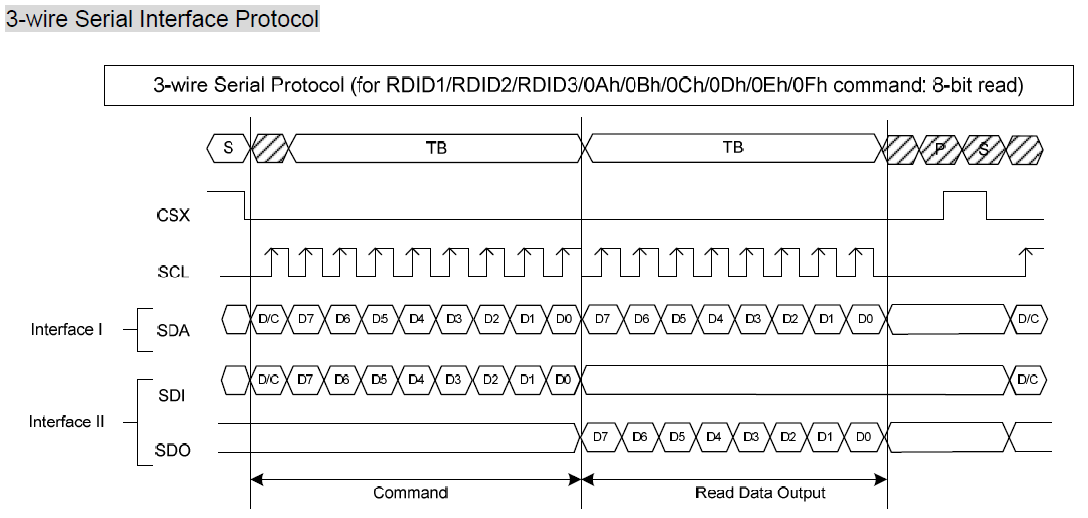

I try connect LCD driver IC ILI9341V.
ILI9341V have two way SPI interface.
1)
2)

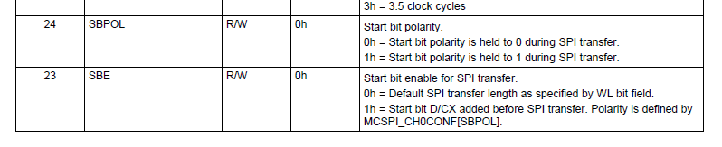

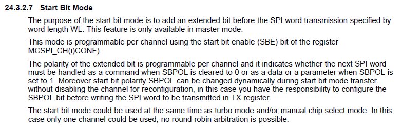

I want use to 1)-Way for SPI Interface.
1)-Way is Start Bit Mode.
Start Bit is 1bit + Only First Byte.
See 24.4.1.8 in the am3358 Datasheet spruh73l.pdf.
Can I use Start Bit Mode ?
I want know How use.
Help !
