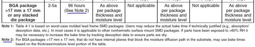

A customer has asked for the appropriate bake time to condition the FCBGA package with respect to J-STD-033 Table 4-1:
They also want the same information for the DM8148, which I will assume is close to the same answer as for the AM5728. But for now we can start here with AM5728, please.
